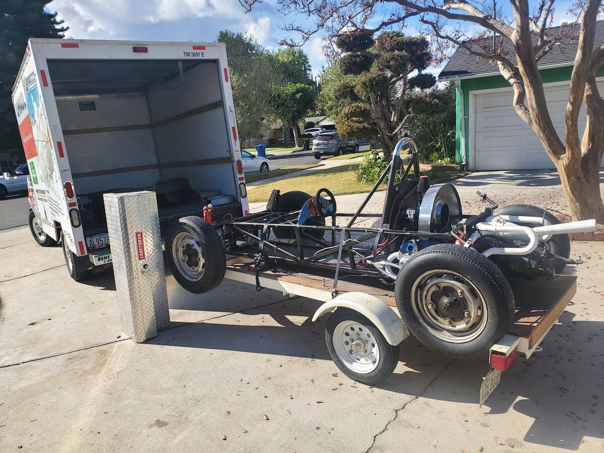

    I purchased the car late last year not far from the manufacturer in Azusa CA. I have been periodically trawling FB and this site in search of a historic vee that can fit a large person - I'm 6'3" and 210lbs before dinner. When I saw it come up I jumped on it the blower, hired a UHaul and UHauled my arse down to socal after an encouraging chat with the seller who was extremely helpful. Here it is as I picked it up:
    No real identifying features on the car that I've found yet, looking for a chassis build plate to figure more out about it's history. But most of the body panels are present and need some minor repair work. The engine and gearbox are complete and there were some spares and accessories.
    Once I got it home to my tiny garage/workshop setup I was able to un-beech it from the jetski trailer situation it came on and see how the bodywork fit. Not too bad at all...

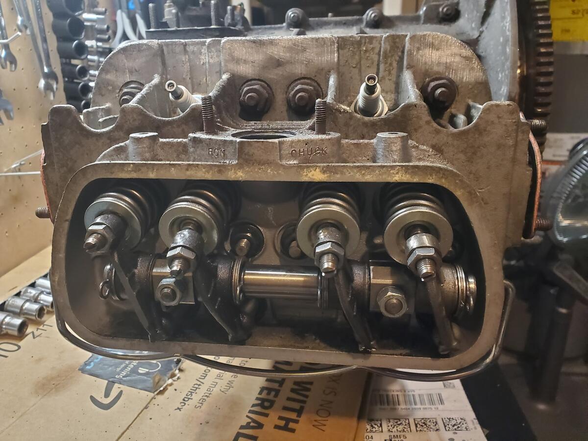

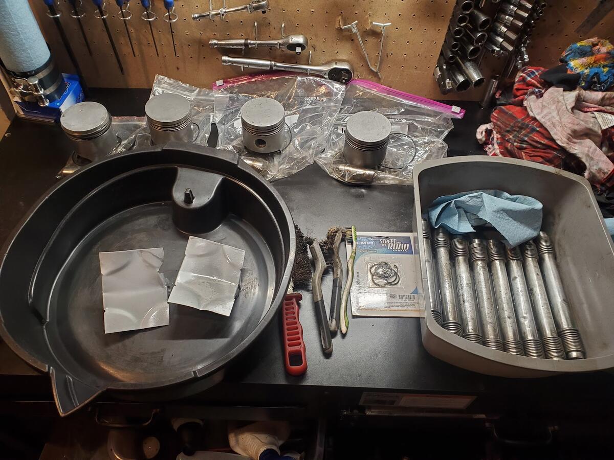

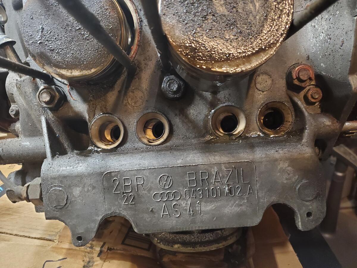

    It does not have anything stamped in the normal VW type one ID locations on the dizzy or oil filler castings, just this plate on the sump that to me read as a 1600cc engine? The openings in the case measure close to the 90.5mm spec which perhaps disagrees with that? I'm new to the VW type 1 game so any tips appreciated. The connecting rods and camshaft IDs read as stock type 1 items.

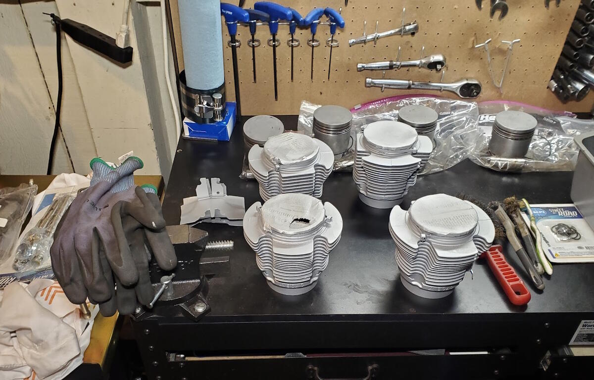

    The pistons feature a small indent (maybe from a valve) and had a few broken oil control rings so I'm glad I started the disassembly. An initial compression test yielded a max of 80psi wet and min of 46psi so definitely some wear and tear on the engine as it sits.
    The heads feature a RON CHUCK stamp so perhaps this was actually raced with this engine at some point? There is also signs of some repairs to the cooling fins both on the heads and barrels.

    Yep, Ron Chuck stamps means you are starting with a FV engine. Good luck

    Quote Originally Posted by brian styczynski View Post
    Also appears the flywheel has been turned to lighten it to the minimum weight...
    I *think* the AS41 Brazilian case is a universal that works for 1200-1600 engines.
    Interesting project, good luck with it!

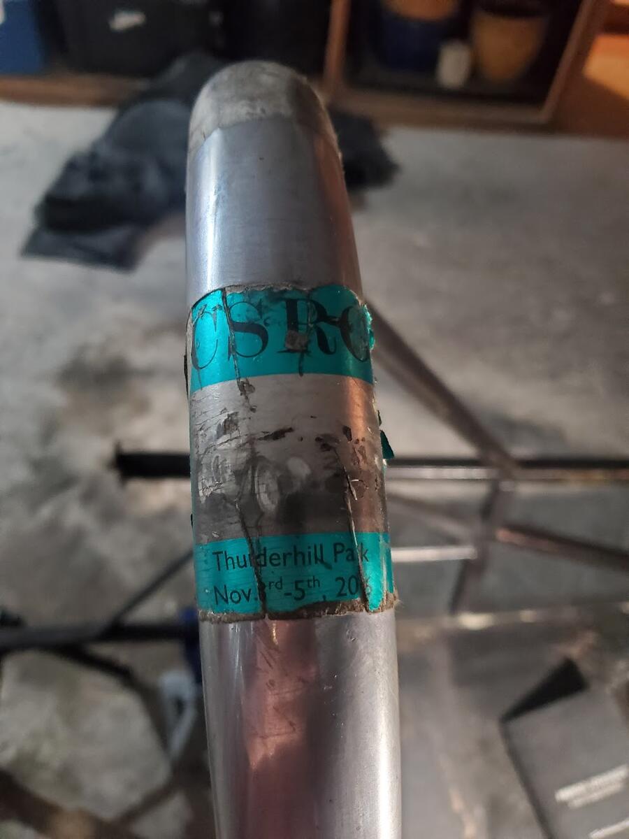

    Adding to the anaemic information I already possess about the car - what do people make of this?
    To me, it looks like a scrutineering artifact from a CSRG meet in 2006. I wonder if the records could be recovered to ID the car? I have sent some emails into the void to find out...

    ... I still haven't hit the holy grail of a chassis number or SCCA number despite searching all over the left side of the roll bar.
    Check the right side of the roll bar too because that's typically where the tech folks used to stamp it. The tell tale is typically a 3/16" hole in the bar where the thickness is checked.

    If it had never been raced in SCCA after 1971, it likely would not have had a stamp on the roll bar, a hole drilled in the roll bar, nor given a log book. It doesn't have any of the expected chassis/suspension mods other than a 'Z' bar that dated from the late '60s through the '70s and '80s.

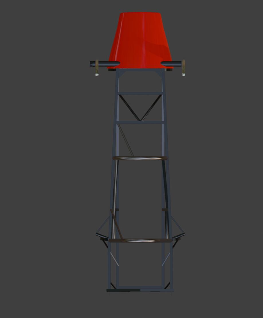

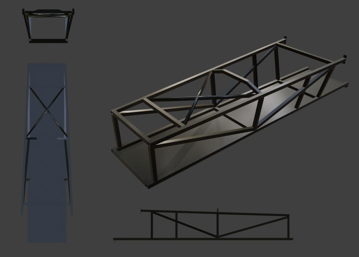

    Bit more progress on the frame measurements. Took the bladder out of the fuel cell, it's a Fuel Safe custom job so emailing them for a replacement.

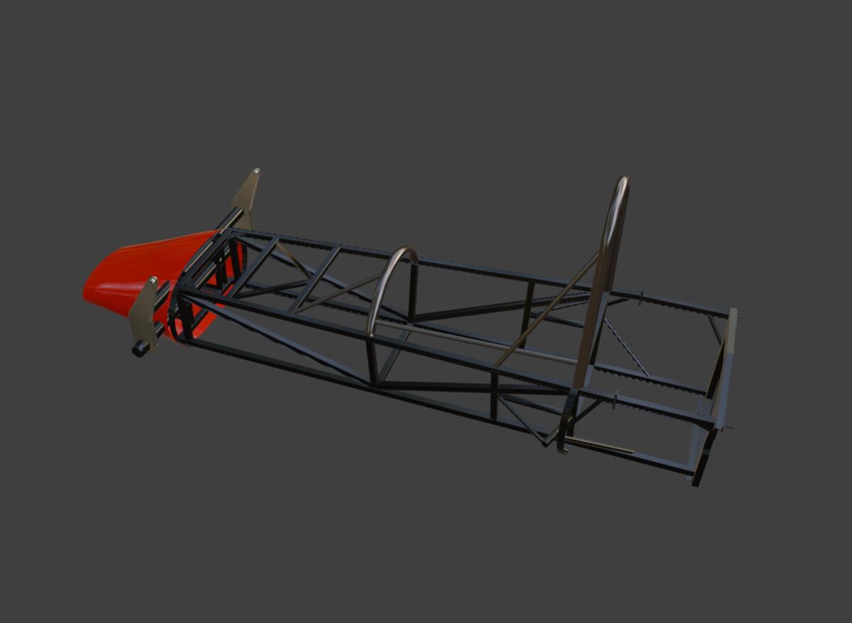

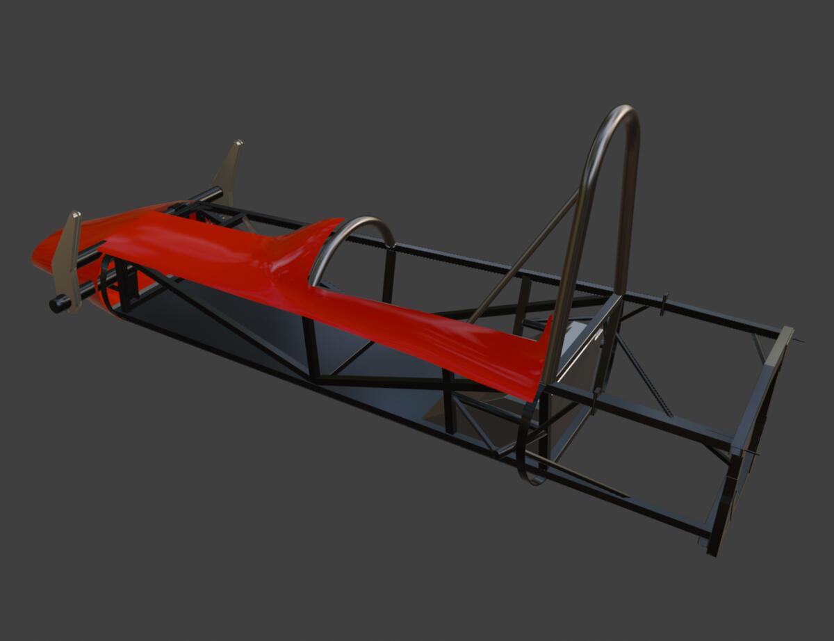

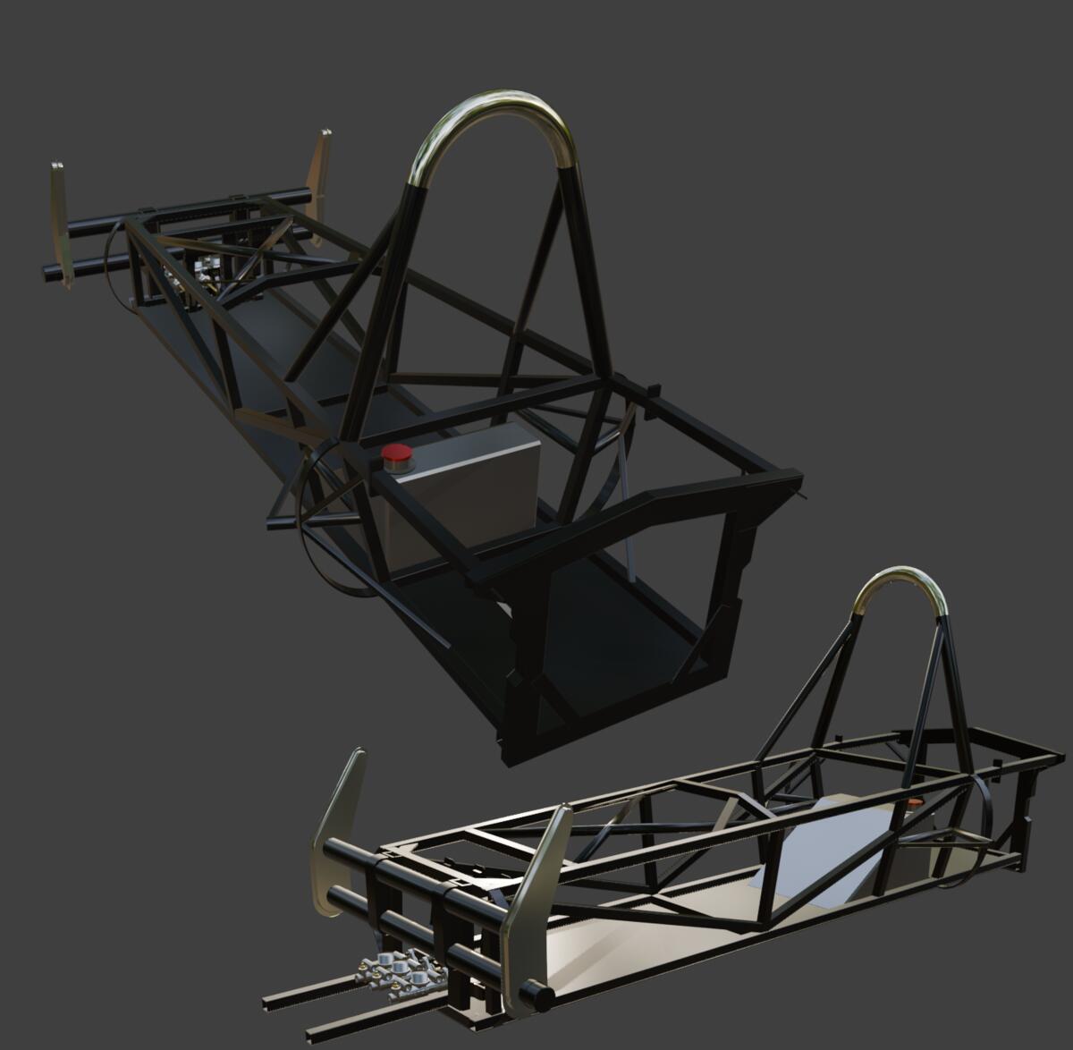

    Alright, bit of a quiet week with work getting in the way but I did hear back from CSRG that the sticker is from 2006.
    Finished the chassis modeling and happy to figure out fitment of a stock ATL fuel cell FC152 to replace the custom FUELSAFE one that can no longer be manufactured.

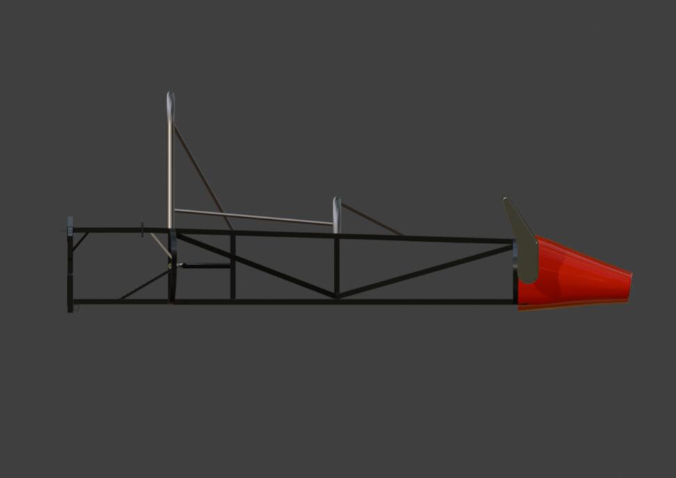

    Welly well well, a long time between drinks but I have progress for you all.
    But before that, a word of advice. Stay off the damn electric scooters especially on the way home from the pub. A few months of healing from a broken face, wrist and other fun injuries has taught me this much.

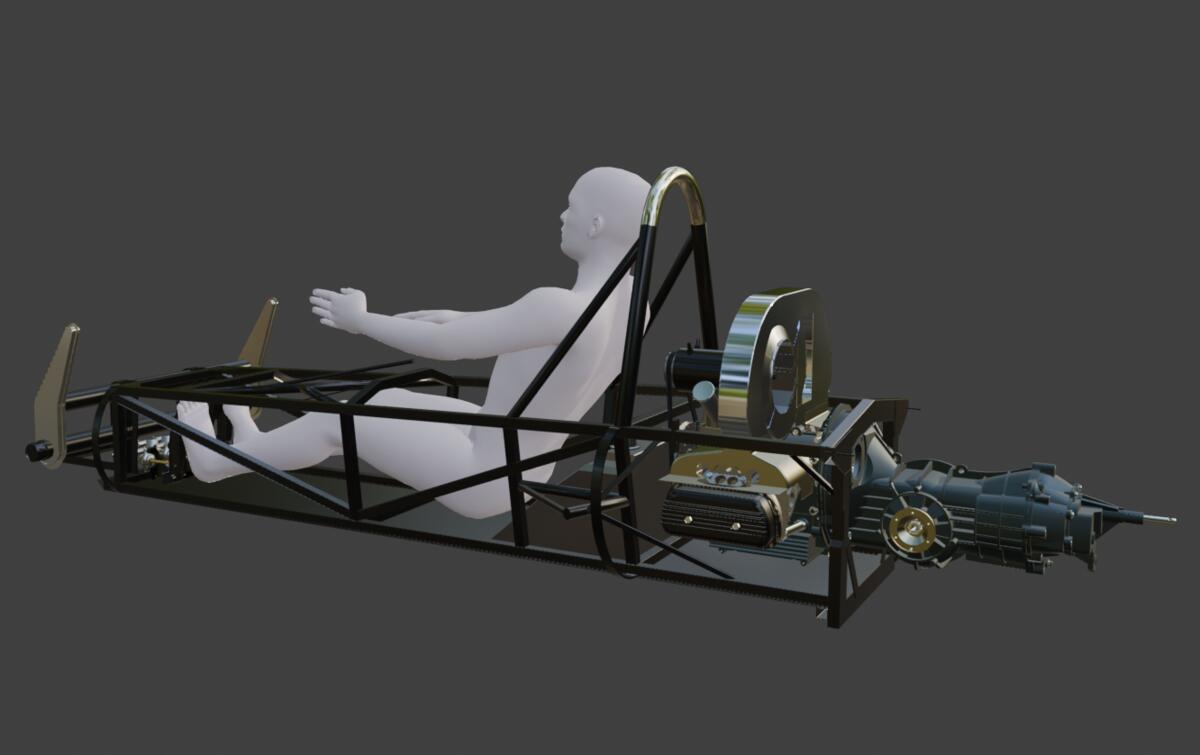

    I'm now able to work on the car again and I resumed by cleaning up the engine and accessories for re-assembly.
    Virtually I have also fitted a drivetrain and this smooth-skinned fella who is going to help me design a seat.

    Looks like a fun project. The RCA cars are so pretty, especially compared to some of the other Vintage FVs.
    One bit of advice... don't worry about the fancy CAD work for a seat. Once the car is done, sit in it & pour foam. Done.
    Oh that's good advice, should save some time. You wouldn't worry about basically sitting on the on the fuel cell? Or constraining the foam to have a tighter form? I wasn't thinking anything too fancy, just a sheet metal seat pan that provides that base and back support.
    Nah, most of us sit on the fuel cell enclosure, because we don't have much room to start with. That will surprise you once you finish the car & get in, especially at your height. The CAD model guy you have is not going to be able to drive the car like that.
    Worst case, put a -thin- foam pad on the enclosure, tape a few pieces of cardboard to limit the poured foam on the chassis side rails, then lay the bag in & pour. You can do an aluminum pan for it if you really want... but the foam will wrap around the fuel cell & stay in place once hardened anyway. It'd just be extra work & weight.
    I literally sit on the floor pan & the aluminum fuel cell, with a small poured foam piece to fill under my lower back, and my butt goes against a panel over the fire bottle. That is it, and it's rather comfy. If I do another one, I think I am gonna try a large lumbar Totim kit for simplicity.

    I might also add that your drawing of your mannequin in the car shows an OBVIOUSLY 'too tall' situation with regards to top of helmet and bottom of roll bar clearances. For an openwheel car, you are required to have AT LEAST 2" of clearance between the top of your helmet (generally about 2" above the top of your head) and the bottom of the roll bar.. *AND* you have to pass the 'broomstick test' where a 'straight edge' from the top of your main roll bar to the top of the bodywork in front of the steering wheel must not 'touch' any part of your body or helmet when you are belted into the car in race trim.
    Strongly suggest that you sit in some other cars (not necessarily just Vees) before make any serious mods to the car you just bought. At your height, you'll likely need every 1/4" you can scrape up, THAT's why we don't build 'seats' into the cars any more (like they did when your car was originally built). We use that space to create a seriously padded, but stout, 'seating arrangement' - not 'just a seat'. We also pay MUCH more attention to the racing harness mounts due to HANS type requirements that have a huge impact on just how you FIT into the car .. as well as 'get into' and 'get out of' it. There are MANY threads on this forum discussing those issues in depth.

    Ok! Some really good points and tips raised here, appreciate the comments.
    Going to take the advice, super minimal seat and let the foam do the work. What do you think of these measurements -- got just over 2" to the top of the roll hoop.
    Re the motor - I had Ron Chuck look it over and he basically advised just cleaning it up and putting it all back together again. I've not split the cases so it should be relatively straight forward. I plan to run and service this car myself for a long time so I have to Iearn the tricks somehow!
    Got the gearbox power washed, barrels painted, and flywheel soda blasted, gonna put the pistons back in tomorrow.

    You are too big for this car!
    Is a front roll hoop required where you plan to race.
    What is the plan for a front roll hoop for your test pipe/tube to actual have something to touch?

    "...What do you think of these measurements -- got just over 2" to the top of the roll hoop."
    Not enough. The measurement should be 2" below the BOTTOM of the main roll bar.
    Also.. you are not allowed to have your steering wheel and HANDS above the to of the cockpit opening. You'll have to 'get down' in the car more.
    AND.. the broomstick test is from the top of the roll bar to the top of the FRONT roll hoop.. or at least the top of the cockpit opening just behind the steering wheel.
    1 option would be to raise the body work between the cockpit and the front beam.

    As others have pointed out, that is not a good fit and doesn't meet the current SCCA rules. Those rules have been developed to protect the driver.
    I had the same problem and as my first step I did the following:
    1) welded a CM floorpan to the bottom of the chassis with a curvature of 7/8 inch (max rules is 1")
    2) moved my butt as far forward to the bottom bulkhead as possible and created a foam crush piece under the front of posterior as a safety crush zone. This has the effect of pushing my knee's higher but there was room (barely)
    2) Moved the rear firewall from the front side of the roll hoop to the rear to allow a bit more lean back which requires a fuel cell that doesn't push you forward (a Citation FV style fuel cell)
    3) Cut the small rollbar support from between the rollbar and fabricated a new one that sits back two inches allowing my head to stay with the slant of my body. The firewall is broken and bending back to that support (which bolts on to facilitate removal)
    4) placed the pedal assembly as clos to the front as possible. The limit here is the front beam and the brake pedal as there needs to be a bit of "safety space" from the pedal to the beam to compensate for brake wear or other slight malfunction.
    Those items, lowering my butt by the 7/8 inch and sitting on the floor, moving back just a bit with the firewall movement, and pedals got me to a safe position IMO. It did not make me comfortable in the car which is round two that I'm finishing now.
    Tall and FV is not a very good mix but it can be done.
    You need to determine what you are going to do with the car. Perhaps vintage rules (I have no idea) do not require a roll hoop at the steering wheel bulkhead. Current SCCA rules do and that should not be difficult to add. The "broomstick" then goes from the rollbar to that roll hoop. Your knees can come up for legroom possibly depending on framework.
    EDIT to add: Looked back through the thread to see that your plan is for vintage racing which would fit that car. I'd check with them on the rules, particularly with respect to adding a front roll hoop. I assume it is not required as I seem to recall seeing pictures of vintage cars with original chassis design. But you definitely wish to provide the safety required regarding space above your head.

    OK .. I have been 'enlightened' - Thanks, Brian. (took me about TWENTY MINUTES to FIND that number in the GCR - seems like that measurement should have been easier to find).
    The helmet to roll bar clearance REQUIRED is in fact 2" from the top of the roll hoop to the top of the helmet. I have always used 2" from the BOTTOM, since I don't want my helmet to HIT that roll bar. If the roll bar is 1.5" in dia, then the top of my helmet at mins WOULD most likely hit the bar in almost every 'bump' I might encounter - even in the pits. I wouldn't like that. If you are THAT close, you should probably put some sort of 'bump' material on the bottom of the bar.
    Anyway - the rule is a MINIMUM, not a 'recommended' distance.
    An earlier question asked about a front roll hoop also raises the question for Vintage cars that I don't know the answer to.. Do you have to MODIFY a Vintage car to INSTALL a front roll hoop? Seems like a vee MIGHT be able to get by without it because of the shock towers.. however, those towers have only a minimal resistance to 'side loads' and fold down easily if they encounter such loads.
    The 'broomstick test' is also not mentioned in the GCR. The applicable location and description of that test is on Page 87 in the latest (March) GCR along with the roll bar clearance. That test ONLY references the Front ROLL HOOP.. so not sure what happens if you don't HAVE one. ?

    Yes, kind of. Most clubs go by the helmet to roll bar guidelines in the current GCR. They generally refer back to the GCR for current best practices with safety issues. SVRA calls for a slightly thicker roll hoop wall. Most regional clubs don't have their own GCR, just lists of what cars/modifications get put into which run groups, along with general safety requirements like fire bottle, belt, and safety equipment dates.
    If I was a tech person at local vintage club, I would say that car would need a front hoop, above the wheel and hands to start with. Then you would need to check the broomstick test again and may still need a taller main hoop. We have replaced the main hoops in our 3 Lynx Bs over the last few years to give an additional 2 inches. All 3 drivers are 6 feet tall. While we were barely passing before, we were able to add proper seat (molded foam) which raises us an inch.

    Looking at this chassis, I would say that also cutting off the main roll hoop and support braces...replacing with taller...would be a VERY GOOD part of the process and fairly simple for a skilled fabricator.
    Remember the top braces should begin no more than 6" below the top of the roll hoop (I recommend 3"-4") and should go forward between 30° and 45° angle...I would try to maintain the same lower attachment point as the current one since it transfers load straight down into a vertical support member.
    Whatever you decide, DO NOT add an "extension hoop" to the top of the main roll hoop!!! These are very dangerous and can fold or snap off under the right circumstances.

    I'm loving all the constructive suggestions here - also got Slim and the CSRG to weigh in via email RE adding a front roll hoop:
    "It has been done on many vintage and modern FV’s. The lower floor pan gcr rule/limit is one inch. In adding the front roll hoop, if It could be relocated further back allowing higher knees and sliding down in the car"
    So, coming up with a 3 point plan of action for operation "5-pound turd in a 3-pound bag":
    1. Chop the old roll hoop off and fabricate a new, taller main roll hoop with better bracing
    2. Add a front roll hoop over the steering wheel
    3. Optionally lower the floor pan under the driver 1"
    Will post some drawings once I've consumed the SCCA safety docs and GCR.
