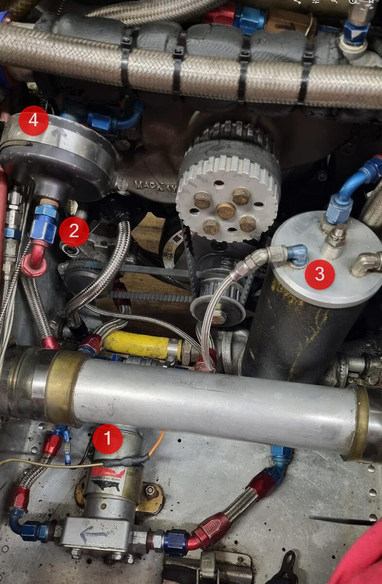

    A question for the experts out there: on my recently bought Lola T333 (the "John Morton car") I have this rather complicated fuel setup - see picture.
    1) is an electrical fuel pump, (2) is a belt driven fuel pump. (4) could be a filter and (3) is a little tank. And a lot of fuel lines that finally lead to the quad-carb (no fuel injection).
    I want to understand it. Is that a usual setup? Do I need to have the electrial pump running all the time?
    Thanks for any insight on this.
    greetings from Austria...............Eugen

    This looks very similar to the fuel system I have on one of my DSRs. I don't know how yours is routed but this is mainly for fuel surge to get every drop of fuel before it dies. One pump fills the small tank which hopefully stays full until the fuel tanks get close to empty and the second pump sucks out of that small tank and feeds the carbs/fi. I would think this setup is more for fuel injected cars that don't have a fuel bowl and can't handle sucking air. Injection doesn't like air.

    Somewhere in that set up there would need to be a pressure regulator - I think that is #4. #3 looks like a large fuel filter to me. As to why there are two pumps I can dream up a couple of scenarios:
    1. The electrical pump is there to add volume so that the carb doesn't run dry on long, high RPM straightaways. We had this issue in my FA (I know the BDA/Weber is a different beast that what you are dealing with) - the fix in the day was to add a deep spacer to elongate the Weber fuel bowl/increase the capacity. But in your application, that mechanical fuel pump is going to be spinning really fast at full chat, so as long as the pulley sizes are correct and the mechanical pump is in good shape why would the carb run dry??? I'm not buying this
    2. The electrical pump is there to prime the carb prior to starting. Otherwise, you'd be cranking that big motor over to build up pressure the fill the carb after the car has sat for a while. And maybe at cranking speed that belt-driven pump just isn't spinning fast enough to quickly prime the carb.
    I think #2 is most likely the case, but it would be very easy to prove it out. Empty the fuel bowls in the carb. disconnect the electrical pump and see how long it takes to start off of just the belt-driven pump. Then empty the carb bowls again, connect the electrical pump, turn it on for a few seconds and then see if the car starts more easily/quickly.
    On track, run with both pumps and get a baseline. Then turn off the electrical pump and see if there is any difference on track - do not continue to run the motor if it is running out of fuel/leaning out!!!!! (On something that spendy, I'd certainly have a EGT sensor hooked up to a gauge on the dash - easy and cheap to do). If you want to get really cute, do a plug cut after running both pumps - then repeat after the electrical pump is turned off. That should tell you what you want to know
    Again, I am only guessing. But let us know what you find out!

    It's all left over from running an old mechanical fuel injection system. Hilborn possibly. For F.I. electric to get started then switch to belt drive.

    Thanks for all your valuable information! I also think this are the remains of the mechanical fuel injection, but I wonder, when they built the new engine in 2018, why did they leave it installed. I am also thinking the electrical pump could be for starting only.
    And yes, there is a pressure regulator near the carb. I have a fuel pressure gauge in the Lola, so I will try to switch of the electrical fuel pump when testing the car and watch the fuel pressure. The Lola has no alternator, so saving some electrical power is probably not a bad idea.
    Or it is how 10rmotor writes it - that is quite a usual setup for racing (I had that in another racecar but with 2 electrical pumps).
    There is a crazy amount of fuel lines there with t-fittings and the little tank has also several connections - so I am not able yet to grasp how that works.

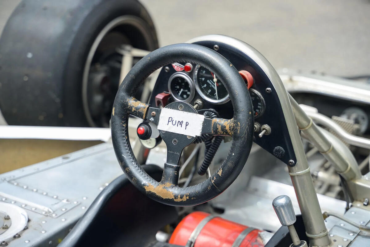

    Unfortunately the seller of the Lola is sick, so he cannot be asked about these details. On the steering wheel he had a big white duct tape with "pump" written on it (see photo below) - either it was to remind him to turn the pump on or off. :-)
    thanks, best wishes...........Eugen

    Thanks, probably one of these pumps feeds the little tank. But there are really many fuel lines with t-fittings in the system so hard to tell how that really works. The little tank has also several lines running to or from it and is connected to the fuel crossover line between the 2 tanks. Without knowing how the little tank is "wired" internally it is impossible to understand this principle for me.

    Thanks for all your helpful information! Yesterday I started the engine and had it running for quite some time and switched of the electrical pump after start up. The fuel pressure gauge showed a slight drop but the setup should run without the electrical pump. Good to know!

    The electric pump was used for starting as the mechanical pump needs sufficient RPM to provide enough pressure for the Lucas system. Generally it was used until the RPM was stabilized on start up and the pace lap then often as a reminder a pit board was shown to turn off the electric pump once the race started and that was mostly done as again often there was no generator to recharge the battery and if left on you could run the battery down in the race.

    Thanks, that is exactly what I now think how it was meant to work!
