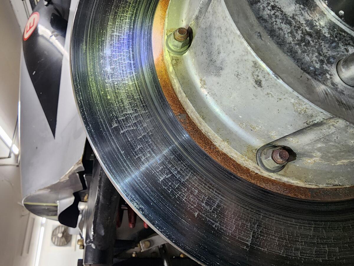

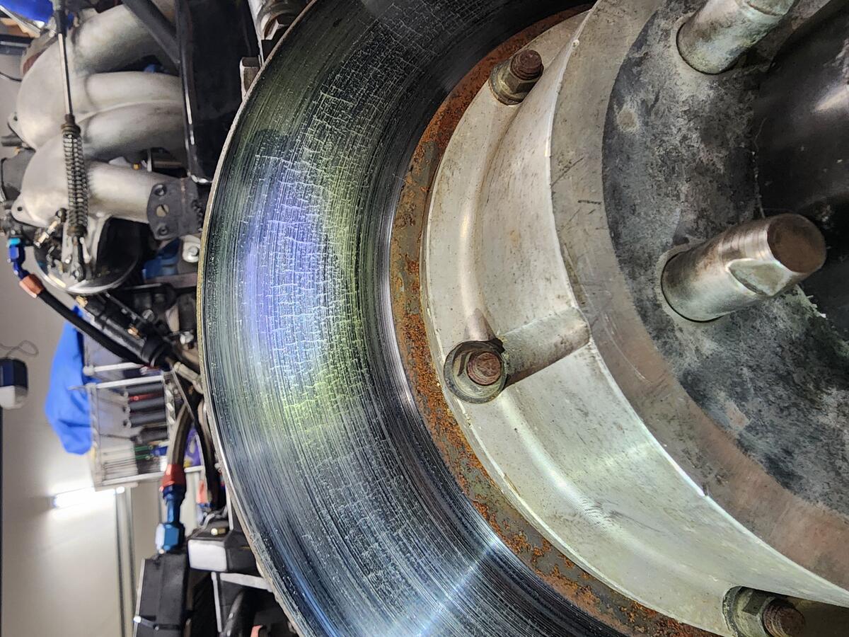

    I was just about to put my wheels on and took a look at my rotors. 3 of the 4 have these marks on them. Are these cracks, chatter marks, or just heat stress? Are these still usable?

    That is called glazing. if you sand that surface off, the rotors will be fine., if they have not warped as a result of being over heated.

    Thanks! I've always heard of glazing but was never sure what it actually looked like
