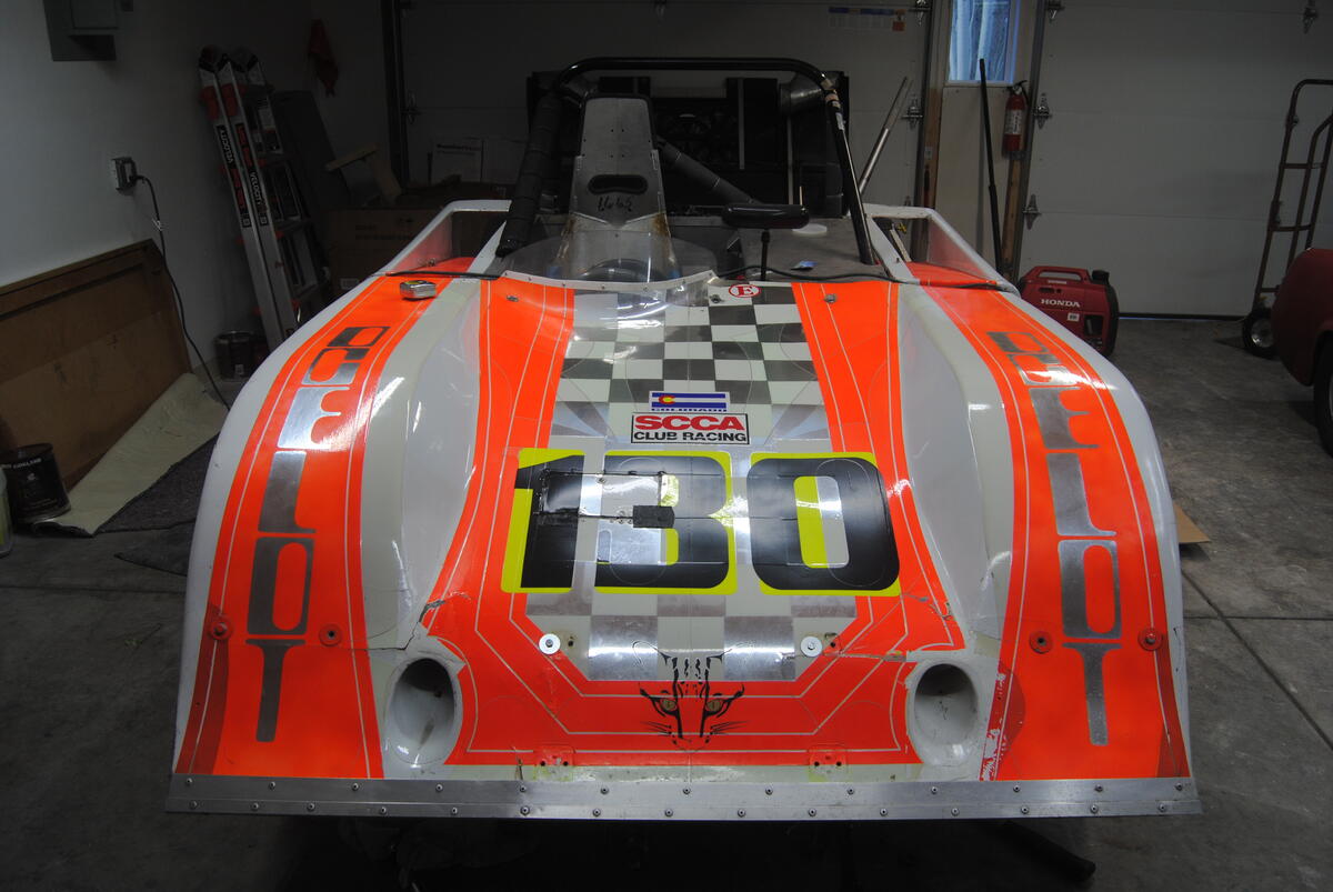

    Got the Ocelot on the track for the first time in probably 15 years only to have it cut short by severe braking vibration. The body has 3" holes for brake cooling ducts. but did not have any ducting when I bought the car. We found the rotors warped so have fixed that and will try again this week. The front upright set is rather standard Spitfire type an the flat plate rotors are both drilled and slotted. So the questions are, first, where would I fasten a bracket to hold the brake cooling duct, the only logical place to me is either the top or bottom of the steering arm? Second, Since it has to be disconnected every time the front body half is removed is there some sort of quick disconnect system? Last, how do modern cars cool the brakes, SRF cars don;t appear to have any ventilation openings?
    Hopefully my pictures get attached. Body photo is from when purchased, cleaned up a bit now.

    SRF's don't go fast enough to need brake cooling?
    Kidding - I'm fairly sure they do have ducts for the front brakes, I've seen them hanging from ripped-off noses enough...
    3" seems overly generous; could probably neck that down to 2" without suffering.
    As for how to attach at the upright end... you are correct, that won't be easy with those uprights. Seems like the only thing you could do, short of adding new holes (which would definitely be a concern for strength) would be to use the brake caliper mounting bolts, piggyback off of those with a shroud mounting.
    That said - you might find you could get adequate cooling by just pointing the hose end at the caliper/rotor... you could support this by clipping a hose to a bracket clamped onto one of the suspension arms. Something like a P clip around the lower a-arm, with something to attach the hose to bolted to that. Perhaps a short length of aluminum tube, which the hose can be clamped to for retention.
    As for how to connect to the front duct openings without a quick disconnect... well, without a splitter you're going to struggle IMO, as that's the easy way to create that quick disconnect. You'd want the hose connected to a tube/duct on the splitter, which then interfaces with a tube/duct on the nose... if you consider those two parts as a single tube, with a diagonal flange facing upward, then when you drop the body down on the splitter then connection is made automatically. And since it's a brake duct, it doesn't necessarily need to be an airtight seal - just so long as most of the air goes where you want it. Think about Porsche and all the brake cooling they achieve just with deflector shields and blades on the suspension...

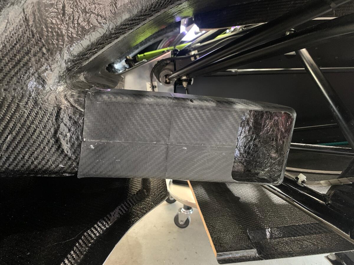

    On Brian Lindstrand's P2 with HRP bodywork we developed a rigid duct that is bonded to the backside of the nose and directs air to the caliper/hub vicinity. It stays with the nose and is not attached to anything else so no disconnection needed when removing the nose. Testing has been good so far.
    I also would reconsider using drilled rotors, especially on a full-bodied car.

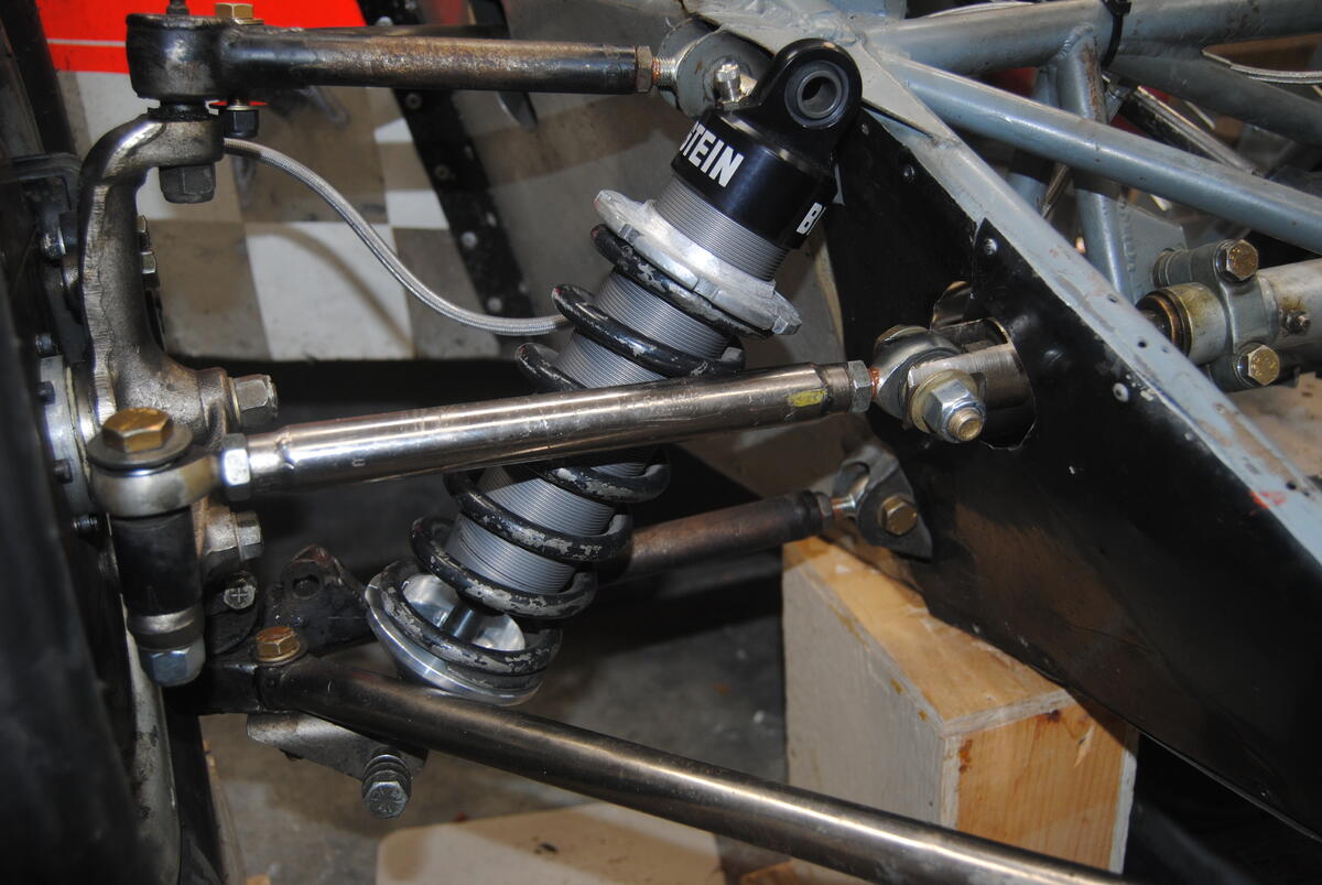

    I'm also going to get some ducting toward the brakes, I have long radius rods(correct term?) instead of the more modern A-arm and will tie the ducting to them for now and just get some air in the general direction. Depending on how it works and the convenience of hooking it up I may try to go to fixed duct later, gut the radius rod movement will always be a problem.

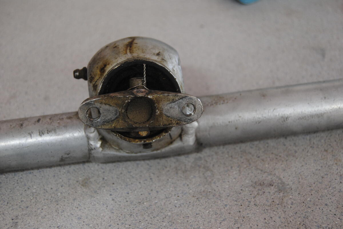

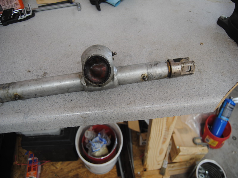

    But the real kicker is I started getting a lot of steering vibration on acceleration. Thinking it was maybe the old Spitfire wheel bearing and seal system or wheel balance, but no the wheels do not have any play. The Spitfire gurus say to torque the bearing nut to 60 in-lb and put in the cotter and it feels may a touch too tight, but works. I'll get the fronts balance checked this week, but it is probably the 50 year old rack and pinion. I've had them apart before and cleanup seems to be the biggest general problem if the outer bushing are still good. We'll see.
  21. #17
    09.08.22
    Salida, Colorado
    20
    The tie rod ends appear to have a cap screw, holding them onto the rack, but neither inch or Metric sizes fit so I can't take the rack apart. There is a lot of play in the cross bar/rubber cross connection from the steer column to the rack. The rack comes with grease fittings but supposedly racks would prefer 140wt oil than grease. The rack has no markings as to where it came from but the pinon is offset rather than centered for a formula car. I'll get some pics.
    The tie rod which is for a 1/2" bold is held on with a 3/8" hex cap screw, (1/2" thd?). The input plate was a bit loose as held on with aq/4-20 cap screw wit a broken tie wire and the input pinon appears to have a worn bushing. There are no identifying marks for the manufacturer for the assembly
Name:	Steering rack 1.JPG
ID:	111567   Click image for larger version.
Name:	steer rack3.jpg
