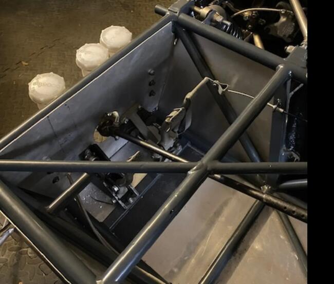

    I'd like to replace my rain light with a dual rain/brake system. I don't want to tap the brake line for hydraulic actuated switch. What systems have you guys figured out that works well with vintage formula brake pedals?

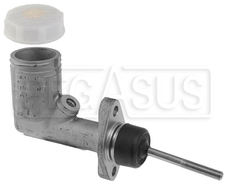

    Default Girling
    ** Actually I'll need to verify that. Currently up on the storage lift and I can't get to it **
    My vintage Girling Master doesn't use a banjo fitting. I either have to tap the hard line or install a mechanical switch.

    look up "backup alarm switch". Typically a spring wand operating a micro switch.

    My GP Spitfire used a switch like this
    Beck/Arnley Stop Light Switch - 201-1105 from Amazon
    Had a small tab off the pedal in the linkage
    worked fine for years

    The Austin Healey Sprite uses a T fitting on the brake line and a pressure switch available from Moss Motors https://mossmotors.com/542-110-switc...ed-pipe-thread
    $10 or a mechanical switch from e- type Jag is available for $27 from Moss https://mossmotors.com/26-1005-brake...tch-mechanical

    Most of us at Sovren run a banjo bolt brake light switch. Easy to add to the rear master cylinder and can be disconnected electrically when you don’t need it. No springs or rods mounted around the pedals..
    https://www.pegasusautoracing.com/pr...asp?RecID=5028
    if you use one of these, use some silicone where the wires come out of the switch as they are easily pulled out..
    use this adapter if you have hardlines.
    https://www.pegasusautoracing.com/pr...asp?RecID=4195
    Flex line is a snap

    I used a small microswitch that has a soft spring lever that just bends after contact with the front side of the brake pedal.
