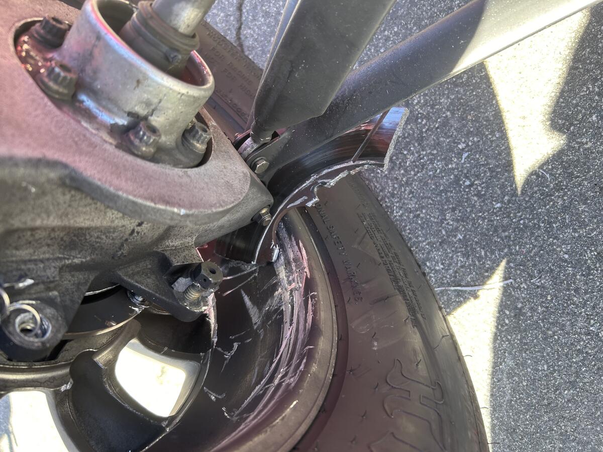

    Default Rotors
    I had a rotor come apart at Laguna a few weeks ago so I’ll be examining and replacing soon. Having a rotor come apart and tear the caliper off not a good thing at 100 mph.
    I've never seen that happen in 25 years of FF.
    Hybels
  27. #23
    Indy, IN
    6,398
    Liked: 2062
    That happens more often than you'd believe, unfortunately. It is usually due to cracks starting from sharp edges and grey cast iron, which thermal stress cracks rather easily.
