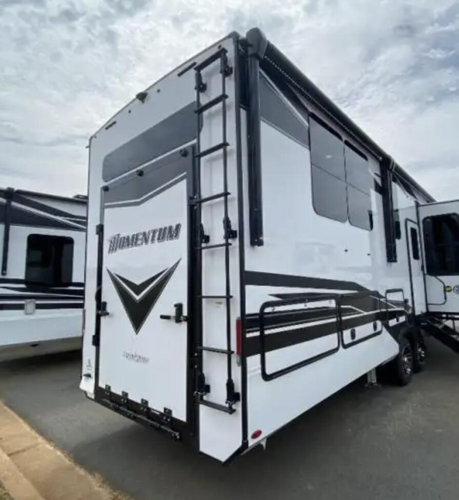

    Ours is a bit different than the norm, it has a motorcycle garage under the rear bedroom with a low ramp door to make riding a bike in easier. Width is 63", length is 117".

    Looks Great for a vee. Nose off and possibly remover rear shifter guard. If Battery mount is on front beam that may need to come off.

    You might find that the center length is longer. Several Toy Haulers I looked at had shorter lengths but the center area is an aisle that is long and wide enough for the nose to protrude into, making the length effectively longer.

    It is not the garage width but the rear door width that is the choke point.

    It fits......the ramp door is the width of the garage, it fits with old school vw rims and tres on it, have to take the challenge cup set up off. The garage is small, under our bedroom with a power floor that lowers down once we load it up. Designed for a Harley which we do often, but it will work for the car as well. It has a lower than normal ramp door for bikes but I will get some ramp extenders as well.
