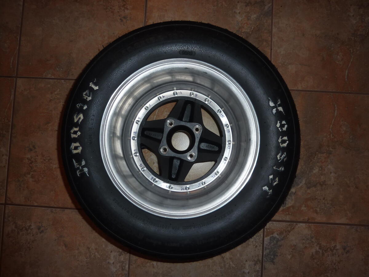

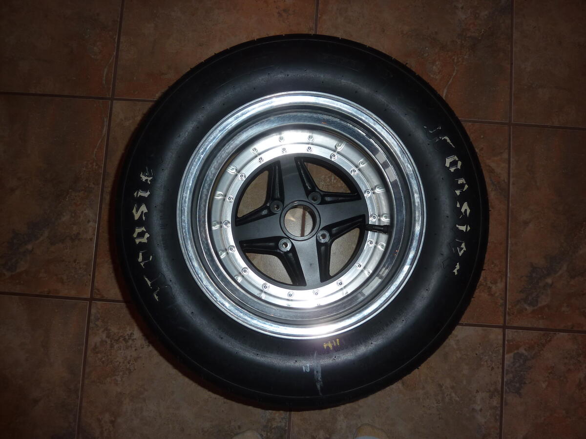

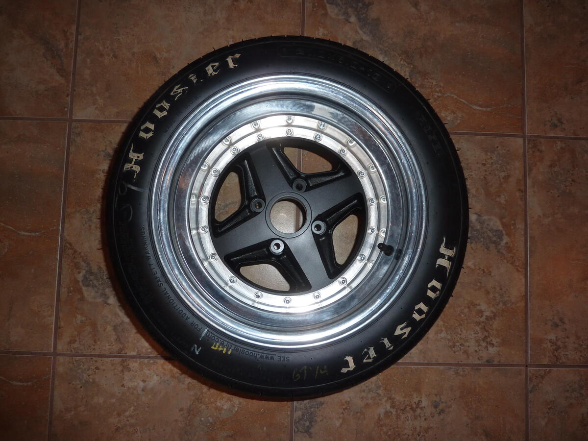

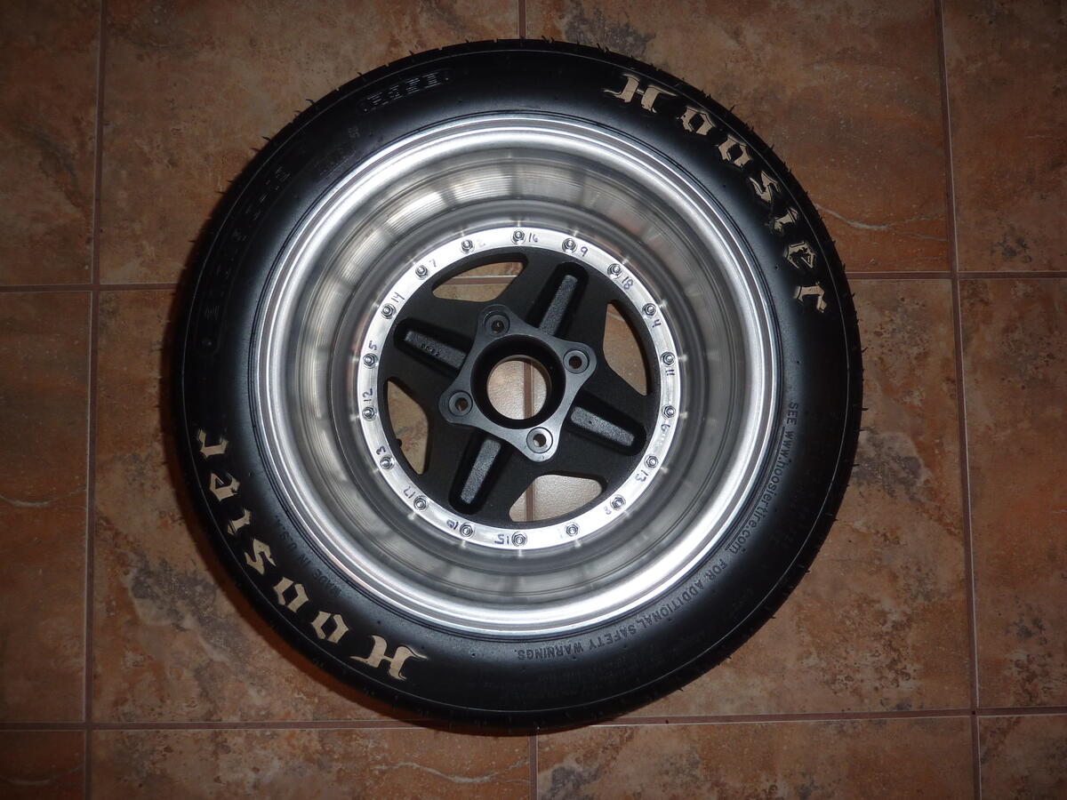

    Hello John,
    see attached photos
Name:	Front inside.jpg
ID:	113226   Click image for larger version.
Name:	Rear inside.jpg
ID:	113225   Click image for larger version.
Name:	Rear outside.jpg
Name:	Front outside.jpg
