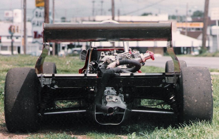

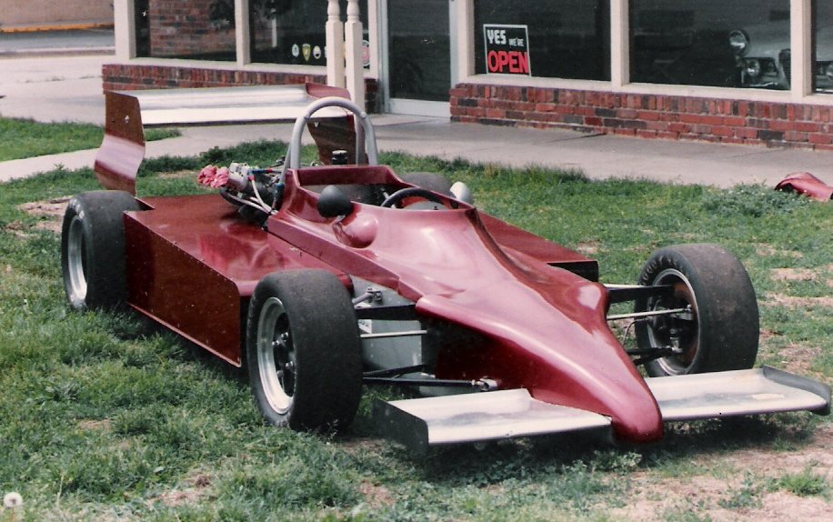

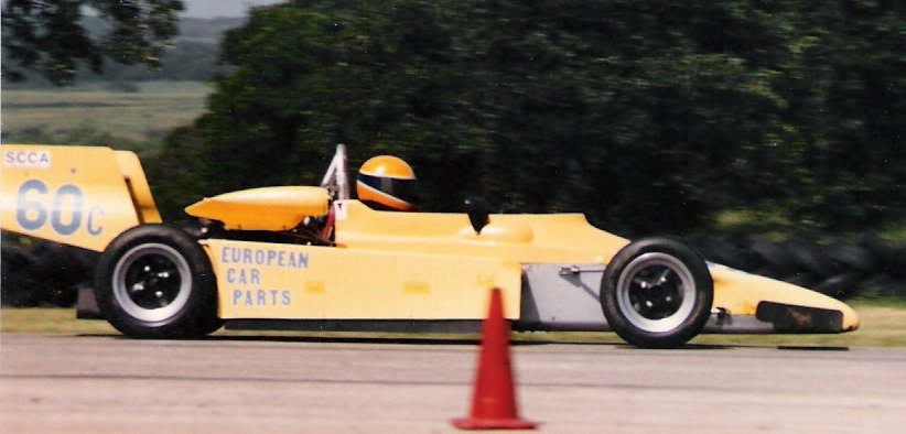

    Here's a few I found ,I will have to dig a little for more. The maroon colored is as purchased,the yellow was after replacing aluminum body panels with fiberglass.

    The above car is the car I converted from air cooled to water cooled Super Vee. This was based on a much earlier design than the Kalagian low liner watercooler super vee. It really was nearly a new and very different car after my redesign. It had tunnels and was very effective. I raced it 3 times the last year I had it and set 3 lap records with it. It had a home built motor with a cyl head that I bought from Kalagian and I built dry sump weber side draft carbs and a fabricated intake manifold, it had big power but no power under 6000 rpm. I do not know how many of these chassis were originally built by but it had the original bent 1/4" thick aluminum U tub with a tube steel upper frame insert and completely new suspension and geometry all around.
    I loved that car and hated to sell it and if it is ever for sale again I want it!

    Jay,I had lots of fun racing it,if I had the money,I would buy it back,restore it and race it in vintage.

    Same here Joe. It was a great car. I beat the FA National champ at Blackhawk Farms with that car and I was in FB. Don't know what vintage class it would run in though?
    Did it still have the dry sump carbs on it when you raced it?

    The last few races with it,I had converted it to Lucas mechanical injection system and crankfire ignition

    Were you using the 25 mm restrictors with the injectors. If so how was the power compared to the carbs.

    It's hard to compare,did complete engine build and update at same time,very good power on dyno and lower rpm drivability much better. It did have the restrictors in them.

    Gonna revive this one. Any idea where the maroon (the car my dad converted) is right now?

    It's still here in Missouri, you can email me at joe@performaglass.com and I'll give you a cell number to call me.
