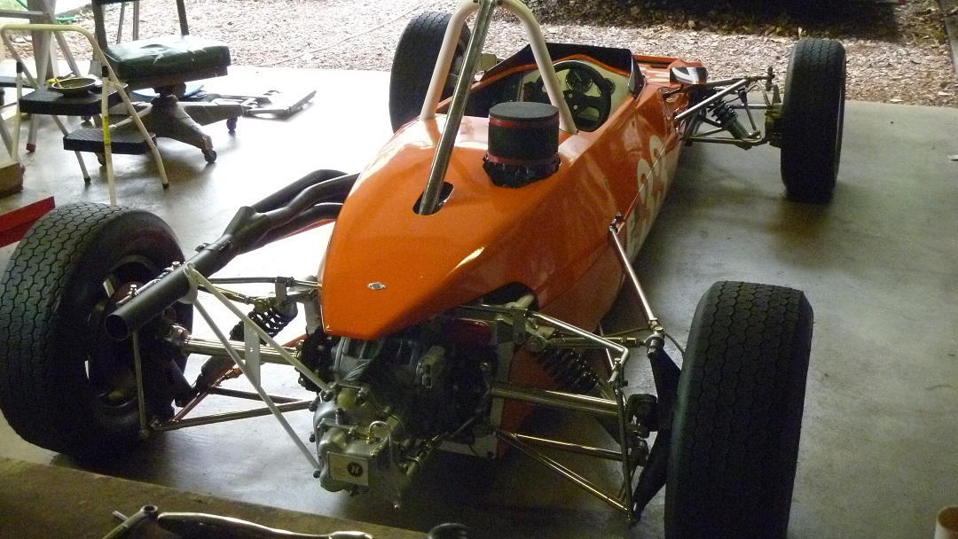

    Thank you again. Here is the long story re. the two Rostrons here in Colorado:
    One of our RMVR (Rocky Mountain Vintage Racing) members, Steve P., owned the two Rostrons; he passed away last summer. Before his death, he sold one of the cars back to the prior owner, and I purchased the second car from his estate. The second car came with FIA papers which reported the prior owners to include Paul Sleeman and Stuart Kestenbaum. The owner of the other car and I got together and compared notes, and we discovered that the FIA papers were actually for his car; the car I have is black bodywork on black chassis and has “J. Firth Racing” decals on both sides. Under the black body paint is green--the car must have been green at some earlier time.
    So, my buddy Terry has the Sleeman car, but I'll copy his ARB for sure. He wasn't aware of the car's substantial history but is happy to have it (arrgh). I’m currently restoring the Firth car, so it is disassembled and the frame is out to be sandblasted and painted. I’d like to determine the year and model of the car—it differs from the Sleeman car (a 1972 CT-3) in that the dash panel is one-piece, welded to the frame (not removable like the Sleeman car) and that the lowermost frame rail is round tubing (the Sleeman car has square tubing). I’m thinking that it may be a CT-2 and am communicating with a guy in the Netherlands who remembers the car when it was being sold by Jamey Firth back around 200X--correction, 2000.

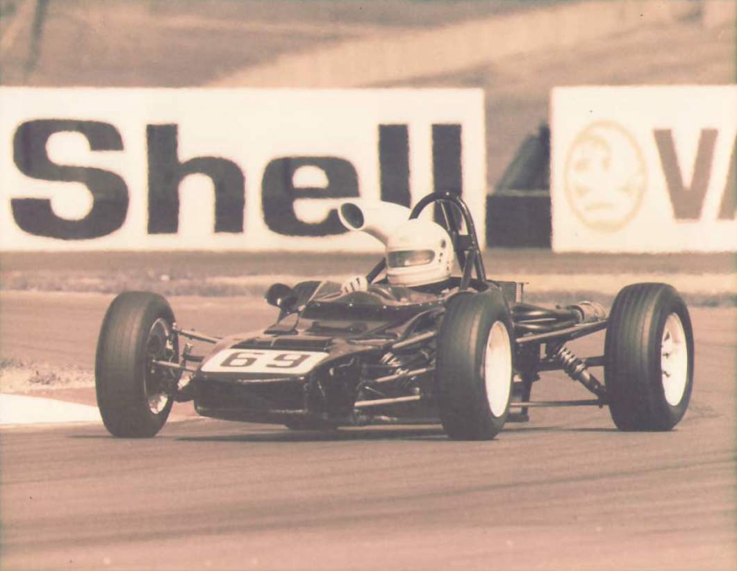

    Rather faded pic of Rostron in 1991 at Donington. Forward facing bars visible. I remember it had fantastic lock; enough to take a second handful in extremis although you had to seriously overcook it to find out.

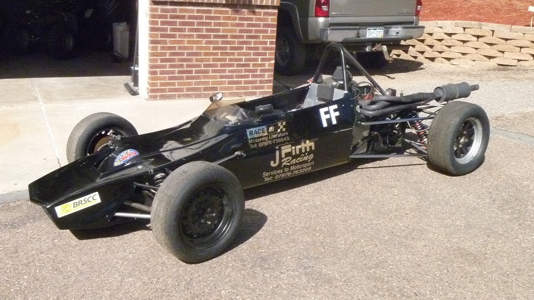

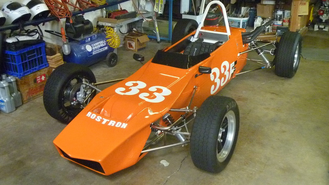

    Stuart, thanks for chiming in. The two CT-3 Rostrons here in Colorado are the only examples I've found, maybe the last two in existence, as only ten or so were built. Your old car (St. Clair/Sleeman/Horwood/Kestenbaum) has great, well-documented history, but I've found nothing for the second car (which I'm restoring). The prior owner of both has passed away, but your old car did come to the states via Chris Alford. UK prior owners for my car are Jamie Firth, Steve Banks, Albert Clements and Dave Cowan, but I haven't found any info for any of them. This car came to the US with black frame and black body work (see pic in post #5) but had been green at some point as well. There are a couple of minor differences between the two cars, and my car may be a CT-2. Mechanical restoration is about complete and I hope to get the body and paint done over the winter. Any recollections you may have would be appreciated.

    I'll see if Albert remembers anything.
    Neither of your pictures show the forward facing bars mine had. Unless your rules about period spec forbid them I can't see why they'd be removed. They certainly make it safer & as a welcome by product stiffer. Not many cars of that era could accommodate them.

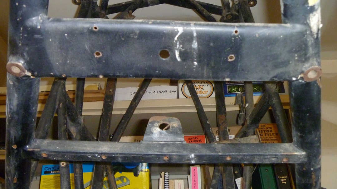

    The frame was replaced after your car came to the states, but the current owner still has the original frame. It shows where the forward braces were attached to the roll bar. I don't know when or by whom the braces were removed:
    The new frame did not incorporate the braces and my frame doesn't appear to have ever had them. They would seem to be a good feature.

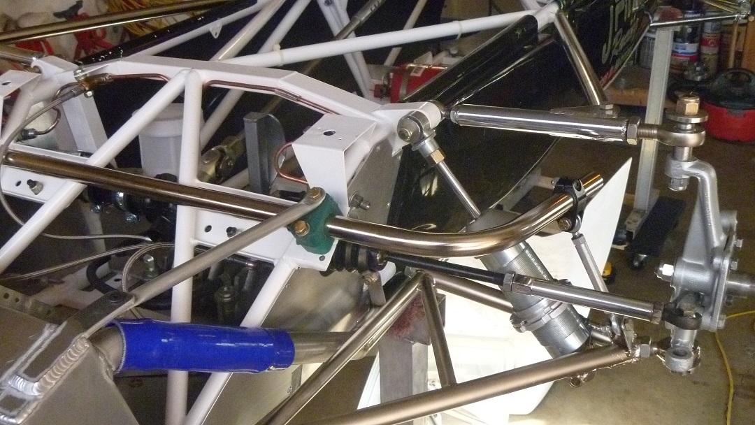

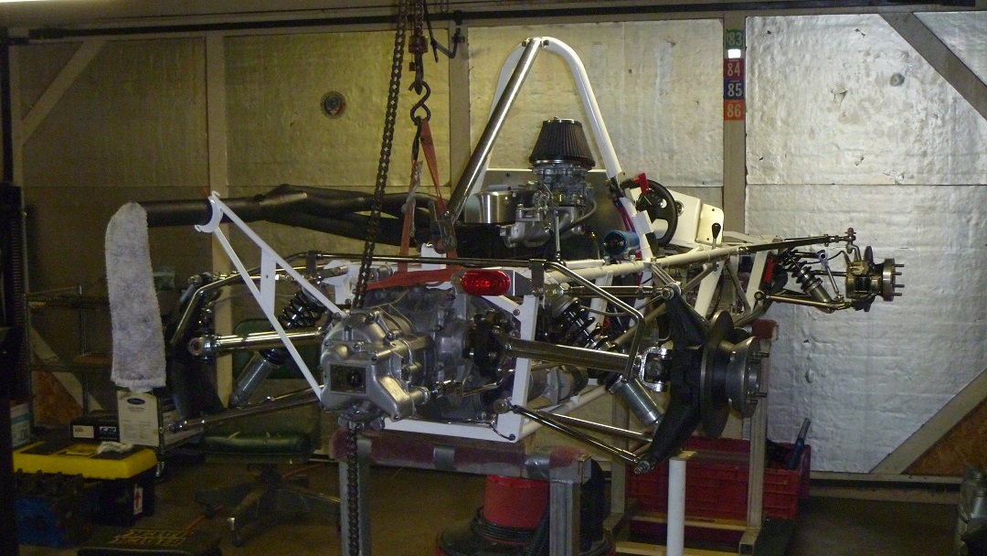

    After much R&D (reconnaissance and duplication), I did replicate the magic front ARB:

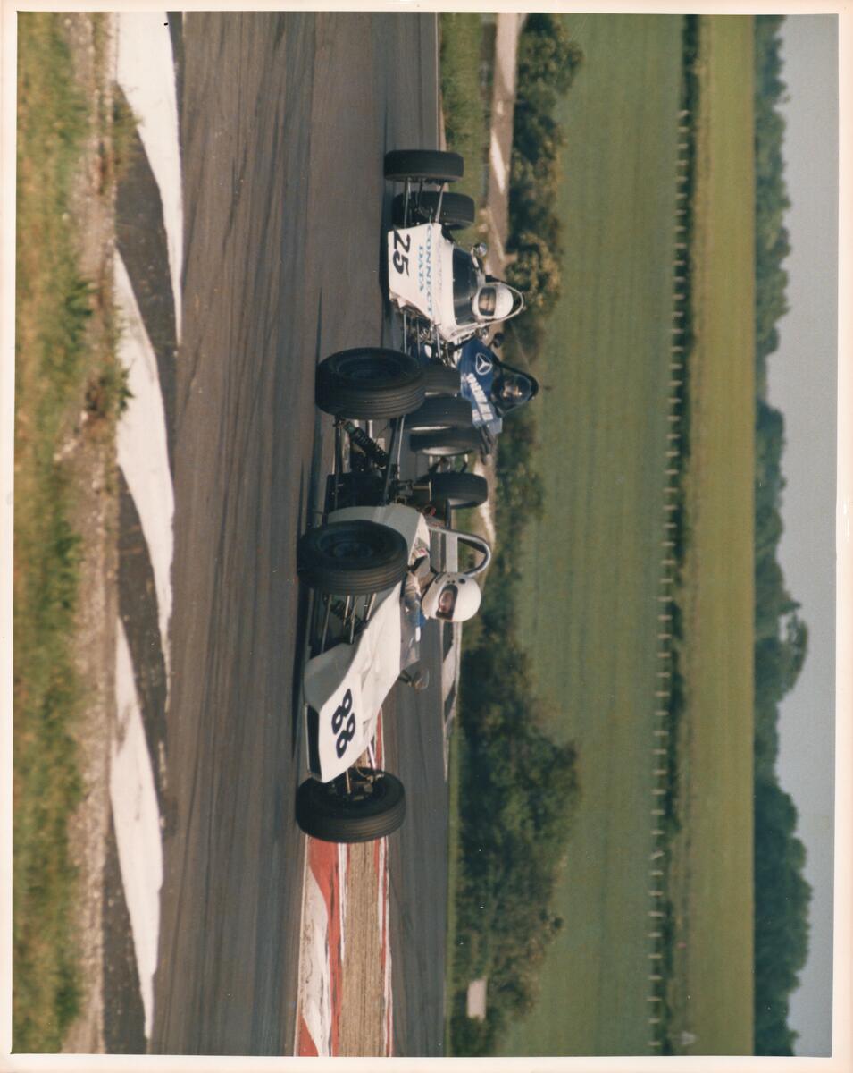

    Like this?

    That looks like Devils Elbow at Lydden Hill to me!?

    Just like that! That does look like Lydden Hill which was Paul's home circuit.

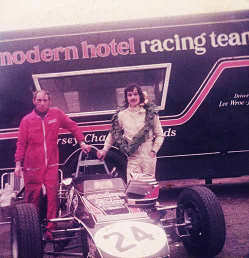

    Hi Guys

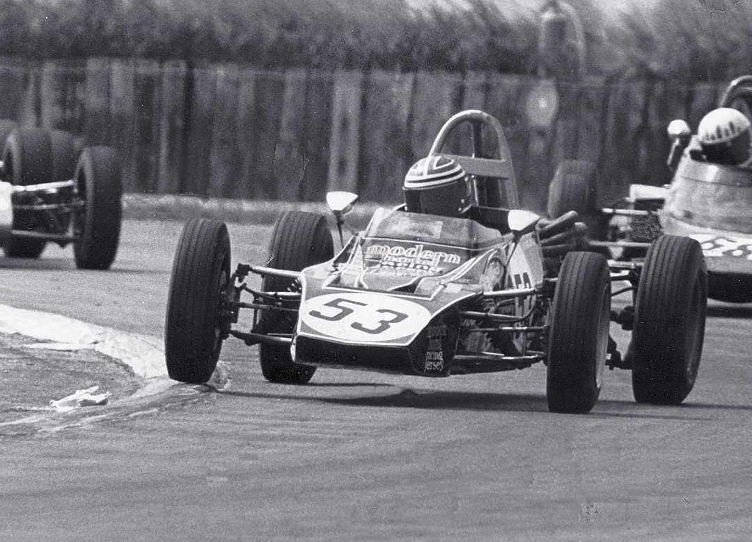

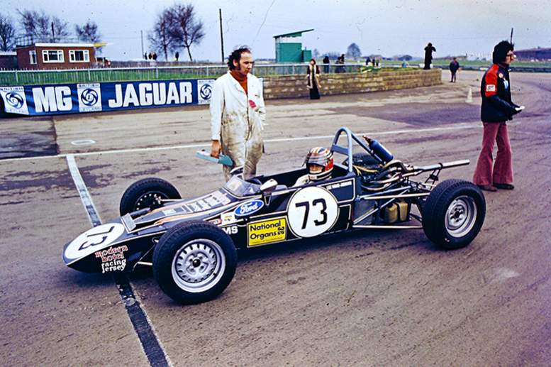

    I came across this as that is me Lee Wroe-Johnson who owned and raced this CT-3 between September 1974 and August 1975. I originally bought it from a guy called Barry Aikenhead who did a few races with it.
    For the 75 season It had a full rebuild by Carl and he found a the chassis was "out of shape". He repaired that and added a couple of minor updates to stiffen the car BUT the big item (which I think may interest you) was I asked Carl (due to my karting days) to design a new pedal box for me with a left foot brake (a bit ahead of time I believe especially for a Formula Ford in those days). So what he did was due to very tight room restrictions he replaced the left foot brace with another brake pedal therefore I had two brake pedals that was joined by a bar so the line up was L to R, brake pedal - clutch pedal - brake pedal - accelerator. Of course the idea was to trail brake and set the car up for fast bends while still keeping my foot (sometimes hard) on the accelerator which keep the engine in the power band. This was my secret weapon and we made a lot of effort to not let anyone know about it including the famous Murry Walker who was trying to get a closer look at the brake box during scrutineering... Anyway thought you might be interested in this....Oh yes it was a successful bit of kit..except for the very first time I tried it in a practice session when I was coming up to Druids Bend in Brands Hatch and went to change gear ..and yes I pushed on the left hand brake pedal instead of the clutch.. Ouch that hurt...I stopped very quickly, lucky there was no one behind me. I still have the welt marks on my body from the safety harness straps...LOL. I sold it in August 75 and cannot remember who bought it to but it definitely was not to Paul Sleeman. It think it was 1976 Sleeman was successful with a Rostron. I believe the person who bought it from me got Carl to revert to the standard pedal box and I do not believe this owner had any success with it.
    I would love to know where my Rostron ended up. Apart from the modified pedal box I cannot remember any other distinctive changes it had. It did have the tubular chassis. It was a cracking little car light and compact car. Carl had some great ideas for the next version of his FF but he just did not have the funds to fully carry them out. Unfortunately due to lack of funds and an illness I had to pull out of racing. So moved to Australia where I did come back to racing 125/250 SuperKarts and what mighty machines these are, unbelievable excitement to drive these awesome machines (I did win a a state championship... ah good old days).
    Anyway guys I hope you enjoyed this If one of these Rostrons you have in your club is mine would luv to hear about it. It gave me a number of wins, poles and fasted laps during my short time with it.
    As you can see I have added a couple of photos of when I had it one photo has the illustrious Mr Carl Rostron who never liked to have his photo taken (he is the one in the red overalls... I am the good looking one...Lol )
    All the best.
    Lee

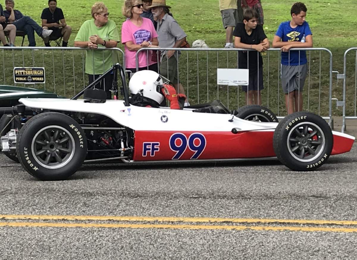

    Here's a photo of Terry in the Rostron this past season at Pittsburgh VGP:

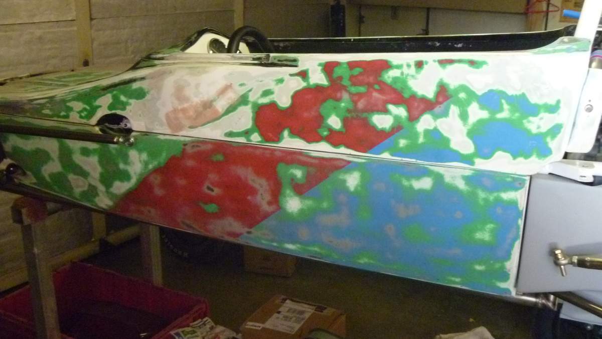

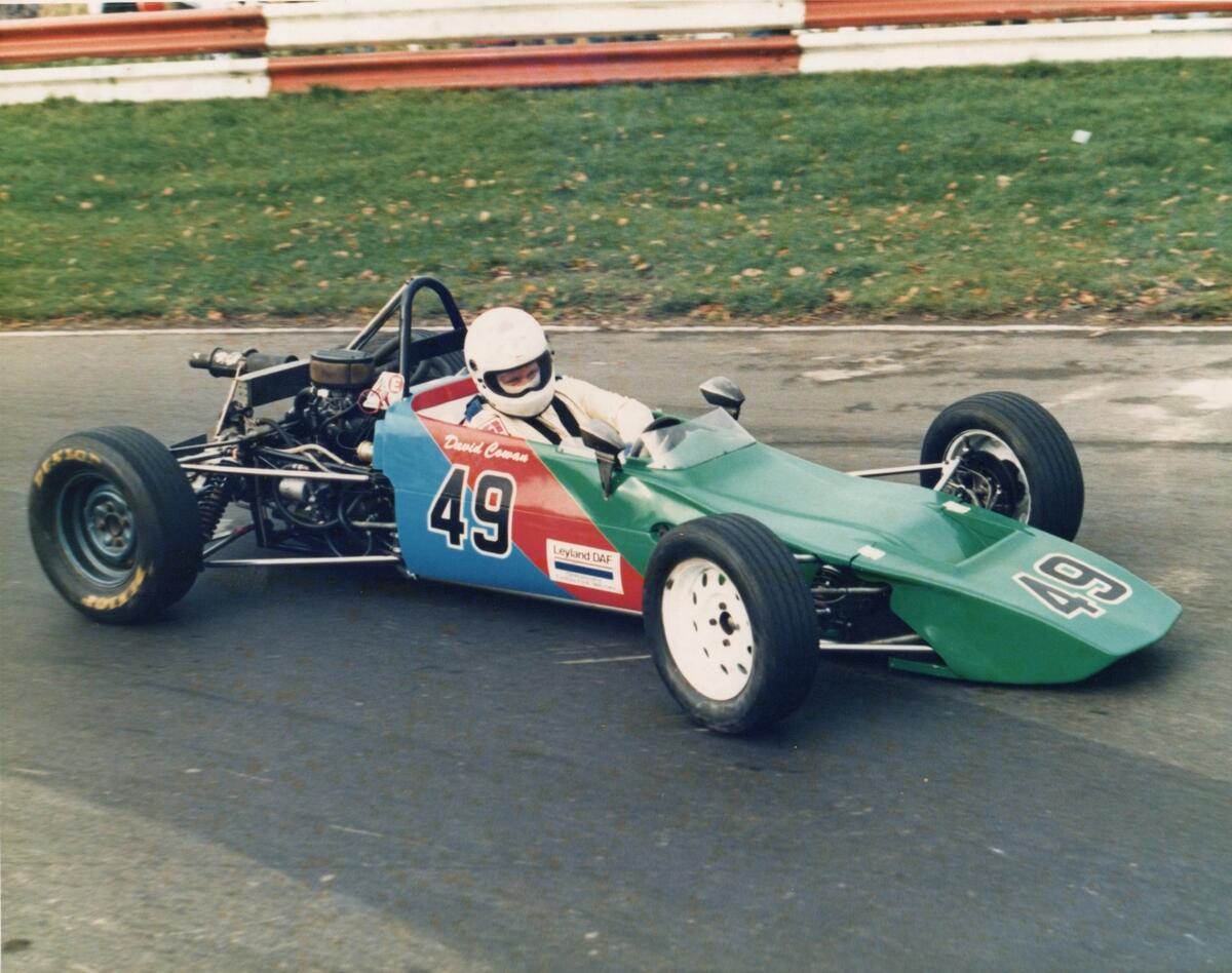

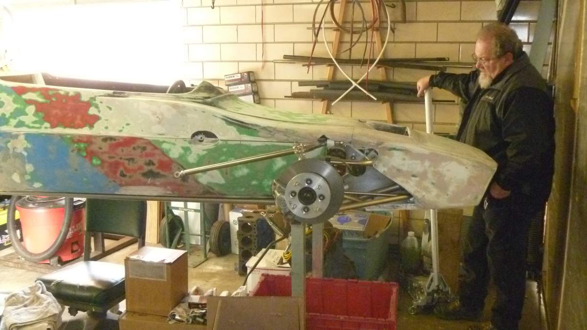

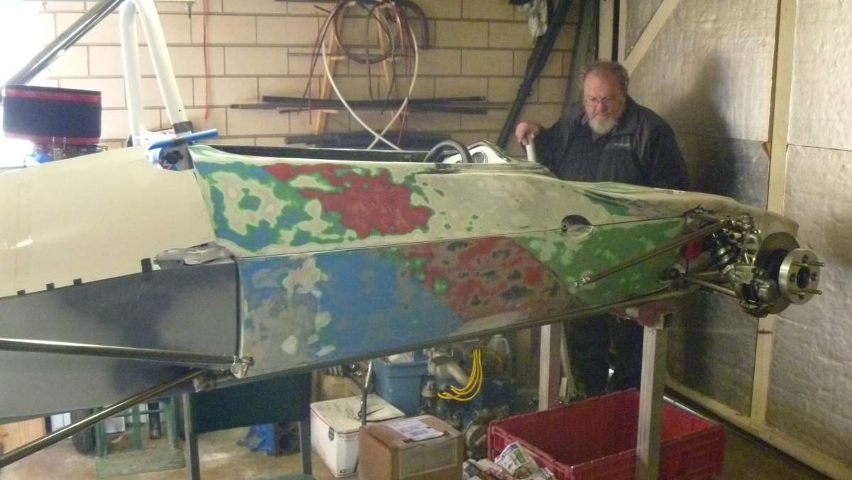

    Getting the Rostron body work prepped, we find this paint scheme beneath the black paint. It looks like the car was all green initially, with the red and blue added later. Since I'm still trying to trace history, does anyone recognize this?

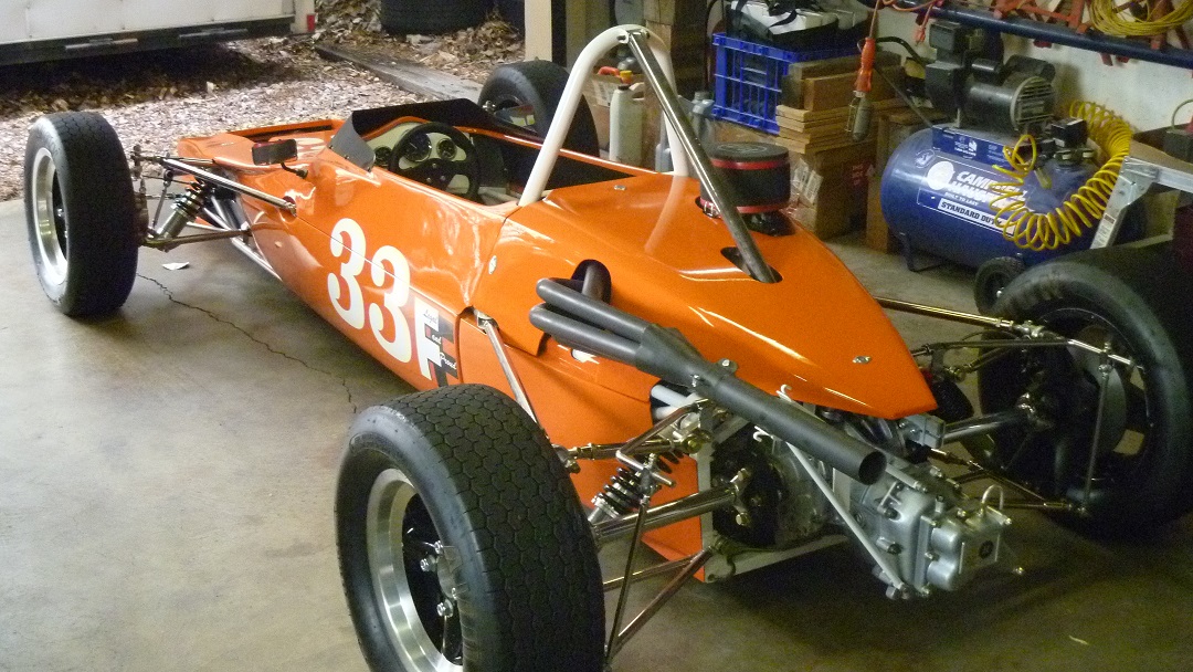

    After multiple delays and sidetracks, the Rostron is finished and back on the ground.

    Congratulations, looks fantastic. Wish you well with the car, you will have a ball driving it. Keep us up to date with progress on track.

    Stunningly beautiful car. NICELY done, Bob. Excellent in every respect.

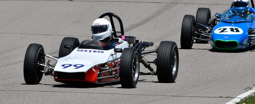

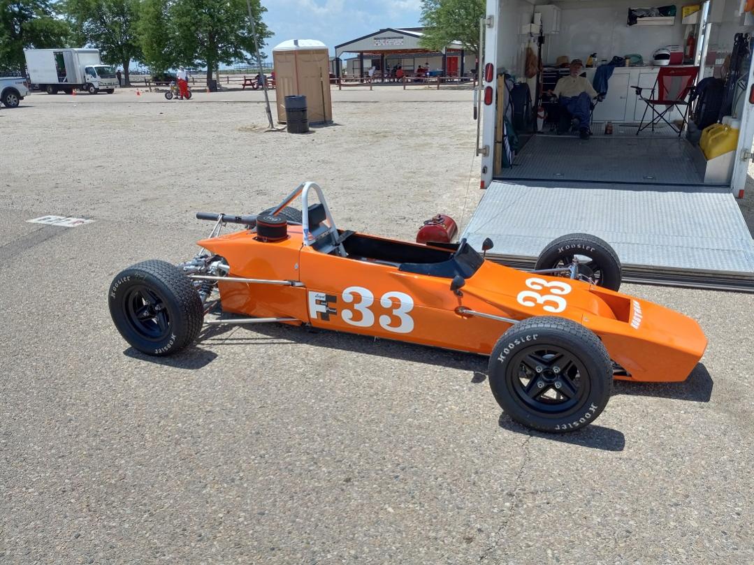

    We had the first event with the restored Rostron at Pueblo Motorsports Park this past weekend. Car worked well, driver rusty, but qualified second in VFF, placed second and third in Saturday races, two firsts on Sunday. I'm in the trailer trying to hide from the heat---96 degrees on Sunday. A very satisfying weekend.

    I thought I had posted this photo, but apparently not. It's from Dave Cowan, one of the prior owners of my Rostron (the orange one). Dave had the car when it had the blue/green/red colors.

    Sorry for being slow to add to this. I saw Bob’s post about the Rostron CT3 I used to own I sent him this picture of when I had it in the green/red/blue colours. I bought the car in 1986 from the former Pre ’74 FF 1600 champion and ex British F3 competitor Steve Bradley. Steve had found the Rostron and raced it once, at Brands Hatch in September 86 and I bought it from him after that. When I got it, it was white as pictured here at Thruxton in 1987. Lee Wroe Johnson’s post from 2019 referred to a white Rostron raced by a Peter Dadson in 74/75, so it’s might have been that one.
    In '86/87 I did speak to a few people about the Rostrons including Mike Thomson, but I didn’t get any background on this one from Steve Bradley. Paul Sleeman referred me to Bob Curl, who prepared the car for Paul and Bob also said to get the front roll bar stiffened. I measured the dimensions of the tubular one and on the ex-Sleeman car and the front roll bar I had made was intended to match that for stiffness; it was made for me by Andrew Duncan who was the ‘Du’ of Dulon – the well-known racing car builders of the later 60s and 70s.
    I raced the car in the Pre ’74 formula ford championship on and off from 87 until 1993. We had pretty big fields of 25-30 cars then and I was usually in the mid field and maybe running up to about 7th on a good day. Chris Alford also bought this one from me and traded it on.
    The Green/Red/Blue colour scheme was courtesy of my dear friends at Brick Kiln Car Bodies who, at the time, were also doing the paint work for the Benneton Formula One team. If you look at the B187 from the time – you’ll see where the paint came from. It had a good engine when I sold it to Chris Alford which had been built for be by David Ray who had previously built FF1600 engines for Adrian Reynard in the 1970s.
    Best of luck with it Bob. Your work looks like and absolutely fantastic restoration.
