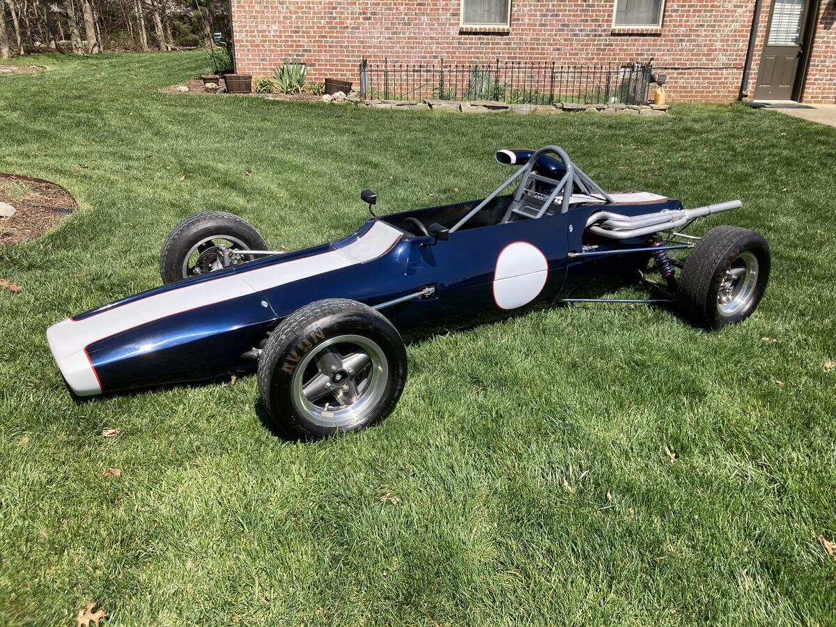

I am 5’9” and broad shouldered and fit my mk6 no problem. I also have one for sale completely restored if you are interested. Great car and with a good driver are very competitive at the pointy end. Attachment 111619
