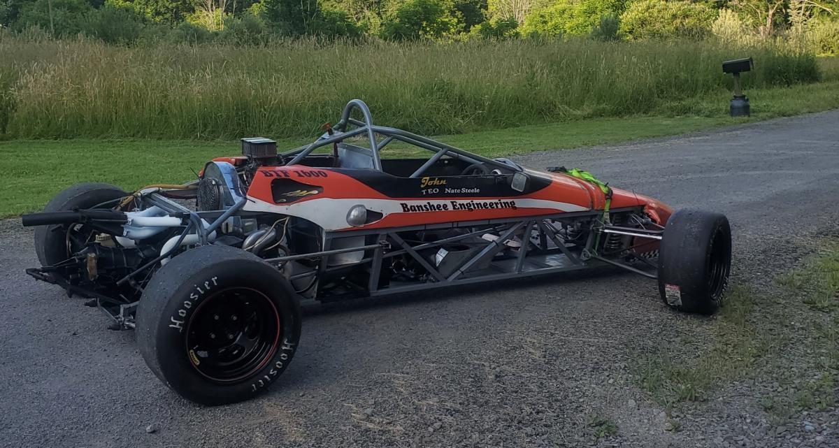

Yep the car sure was painted orange / black / white with John's name and another individual by the name of Nate Steel. I removed all the stickers and am in the process of repainting the body (probably) black with neon yellow accent. The car is basically stock besides 15x8 & 15x7 wheels, Hoosier R25B tires, new master cylinders and EMPI 34 PICT carbs. ( I could never get it to run right with the Webber 32/36. I tried for months. I think the lack of a preheat tube in the manifold was the culprit. So I got the EMPI'S ) I took whole engine apart and resealed everything. I ran the Weatherly hill climb with it this year and a Pocono track sprint, car is a blast in the corners but I need to either re-gear it or put on a stock VW trans in. It is horrible at a launch with the road racing gears, all it does is bog until about 3000 rpm. I suppose if I had the stock hard tires I'm sure I could get some wheel speed with launch but the the R25B's are just to sticky for the low power.
The car was ready for the dump when I got it so I took my time to strip it all down and repaint it. I've always wanted a formula car and this is perfect for my budget.
This fall I started piecing together a turbo kit using a KKK K04 turbo. I want it to spool quick out of the corners since most all the PHA hill climbs have a lot of steep graded hairpins. Unfortunately I had some very expensive vet bills recently with surgery's for one of my dogs. So the plan is now to just hone the cylinders and re-ring it for next season and practice on my driving. If I had the money I would definitely stroke it to 2000 something cc's with bigger carbs.

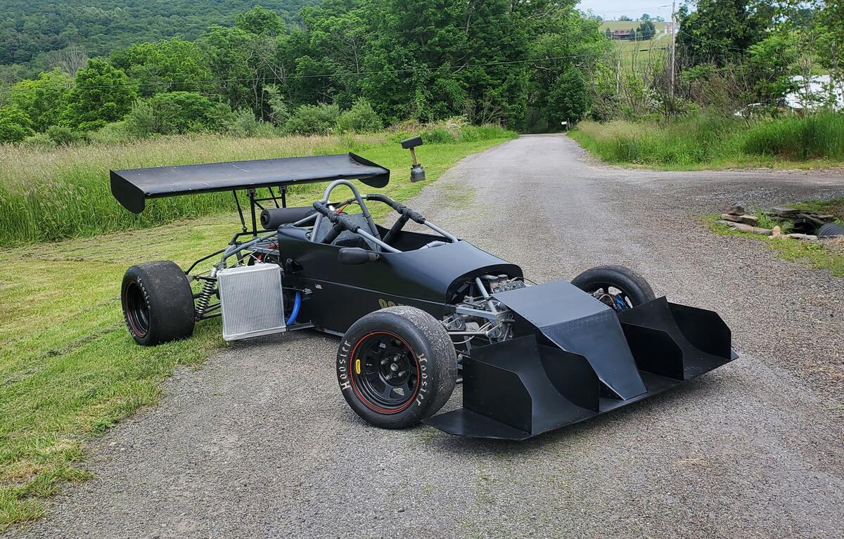

I have an old Lola frisbee Can-Am wing for the back that I have been slowly making attachments for but I will not be adding it until I figure out what I want to do for the front wing. I will either make one or was thinking of using a micro sprint front wing on each side of the nose.
Here's some pictures of it at the end of the season.
Also the class I have to compete in with the PHA puts me in S1 which is all bike engine formula and 2 stroke sports racers so I'm really just trying to have fun. Really no chance of competing. A turbo would bump me to S2 which I would be more competitive in.

I hope your dog is doing well again. Yep I will update the thread with pictures when I get all the mounts and bugs worked out. Thanks again for the info on the banshee. I was definitely thinking about a kind of DRS unit / airbrake for years. I have to look at the supplemental hill climb rules to see if they allow for moveable aerodynamics. The only downside is if I'm expecting the wing to be at an aggressive angle of attack coming into the corner and it gets stuck flat I'd have less downforce. I'll play around with the idea some more.

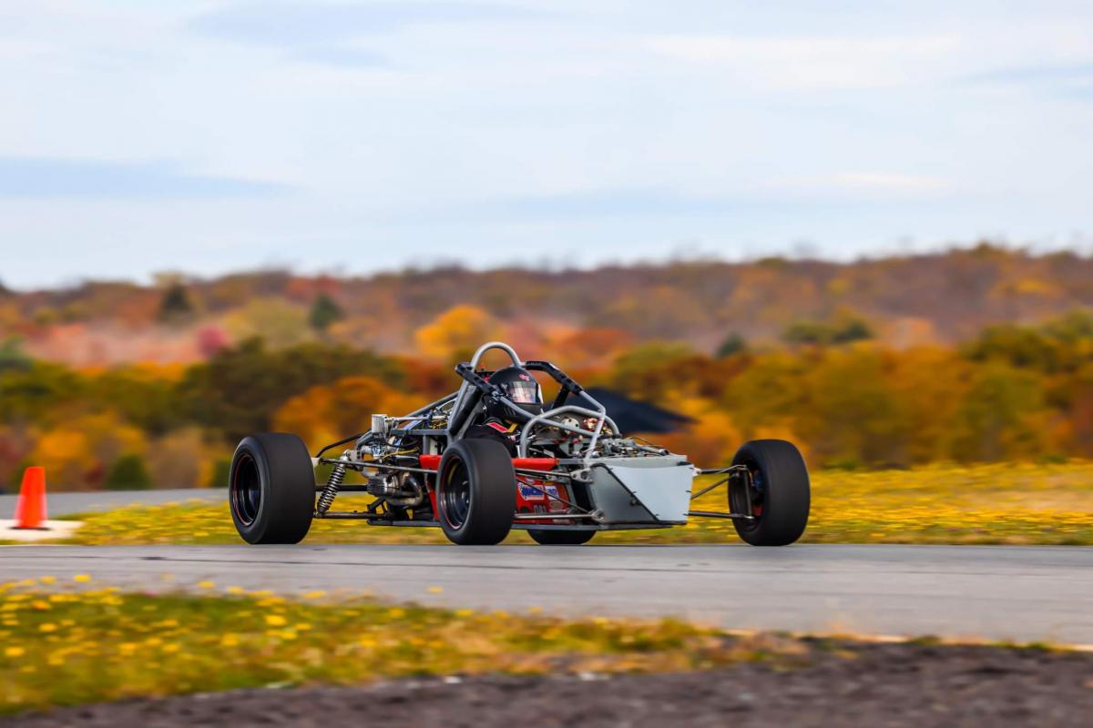

Yes. I got the roller from Joe. He lives close by. He made me a package deal on the roller, the big VW motor (getting rebuilt now) and transmission. I'm in Fort Washington PA. Been running a shifter kart in Philly AX.
I just picked up a set of Bassett wheels and 4 Avon slicks.
Plan is to get it all back together before Spring. I have the body panels, but they definitely need some work. Looking forward to finally learning fiberglass repair.

Oh, okay. Yea that car is going to be pretty quick with that built VW. I'd stay with that. Reason I went 2 stroke was because a fully built air cooled just wasn't in the budget and the 2 stroke makes pretty decent power for how light the engine is 'about 75 lbs dry' 97hp. No I don't have any go pro video yet since I've been fighting with carb and CVT tuning all summer. There are some clips of it on YouTube at the fall weatherly hill climb at 1:26:51 and 2:13:15. I have everything out of it right now. Its getting repowered with a different 2 stroke engine and probably diff drive instead of chain.
