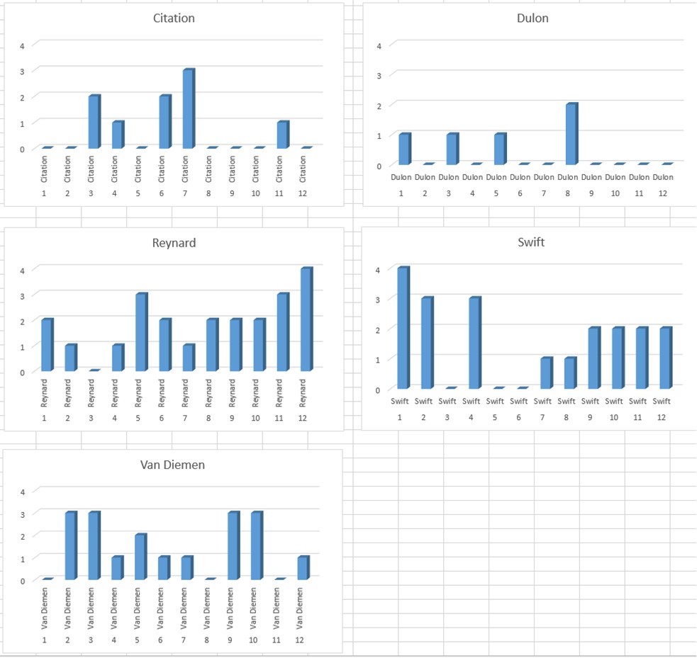

    1. Is there one FF model/year that is a clear choice for CM competition in SCCA Solo II? I've read that there are a number of cars out there that are competitive, and to get the one that fits you the best. But, is there one brand that's a favorite? For reliability, ability to be tuned, parts availability, etc?
    Looking at the CM results from 2008-2015, I've attached the breakdown of placings by the various makes and years of cars. The horizontal axis is the finishing place, the vertical axis is the number of times that car has finished in that position from 2008-2015. Example: No Van Diemens took first, but 4 Swifts took first in that time. I fear there is some self-selection within that data set as the results had less variety than I was expecting. Maybe some chassis have proven to be quicker/easier to adjust?

Name:	CM results.jpg
