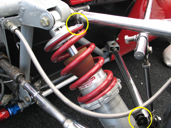

    I wondered if you gentlemen might educate me about droop limiters - their history, their effects on handling, pros and cons of various droop limiter devices/approaches, etc.
    I'm currently studying a March 822 (i.e. 1982 model Formula Two car) and I understand that its owner had its KONI front shock absorbers "droop limited" internally when they were rebuilt. What does that entail? At first I imagined a nylon spacer inside the shock, but I guess a rubber spacer or a spring might work. What's the usual practice? Is this something that might have been installed from 1982, or is it a more modern technique? How common are droop limiters on newer Formula cars?
    Obviously there are other ways to skin a cat. For example, a chain or cable could be attached to the mounting tabs I spotted on this older Brabham BT29:
    Is a droop limiter something that you'd want one weekend (at one racetrack) but maybe not the next (at another)?
    Thanks in advance!

    I admit this still doesn't match my intuition very well, but perhaps if I sleep on it a little more... In the meantime, I've written four rough draft photo captions for an article. Have I synthesized the information above correctly? PLEASE let me know what you'd change to make these captions more accurate.
    (caption for the first photo)
    Phil Harris of Truechoice installed internal spacers to shorten the stroke of these KONI shocks.
    (caption for the second photo)
    "Droop limiting" is a common technique for altering the the dynamic behavior of the front suspension on relatively modern Formula racecars. When the chassis rolls far enough to engage the droop limiter, several interesting things happen: (a) the roll center shifts to the inside tire's contact patch, (b) roll resistance increases sharply, (c) further weight transfer is somewhat inhibited.
    (caption for the third photo)
    So what effect does droop limiting have from a driver's perspective? Droop limited front shocks made Justin's March 822 seem more "neutral" (less understeer) in fast corners and also gave him a little more margin for confident trail braking.
    (caption for the fourth photo)
    Some racers dismiss droop limiting as a band-aid remedy for suspensions with too-soft wheel rates. I don't know about that... but I do know that the wheel rates on Justin's March 822 are ~800 #/inch (front) and ~950 #/inch (rear). Justin advises that the car feels VERY stiff until you get it up to full speed, but that the suspension works over a larger range of motion than he expected.
    Is it the inside tire's contact patch? or outside?

    Inside, if Richard Pare's explanation (above) is correct. Note where he wrote:
    Since the inside wheel is already at full droop, the car can no longer roll about the roll center. If the car is to roll at all, the pivot point becomes the contact patch of the inside tire. (emphasis added)
    Sitting here at my dining room table, pretending I'm a Formula Two car's front suspension, I'm not really sure I believe that my roll center has moved to my right hand (i.e. "inside wheel"). But I had a long talk with Keith on Friday morning, and he did help me understand what's going on much better generally. I'm re-writing captions now because I have a lot more information to cram into them.
    Marty's comment about accelerating forward & the car's tendency to squat has certainly helped my understanding. Anyone else have something to add?

    Think about it for a second - when the inside suspension cannot droop any further, if the car is to roll about any point other than the contact patch, the tire will have to either decrease the squash from whatever there is left for load on the tire, or, once the tire is fully unloaded, it would have to lift of of the ground. In our cases, the roll movement is all in the outboard suspension (except for what little tire squash can take place), so the car actually lowers its ride height, which in turn decreases the progression of the suspesion self-stiffening fron the jacking effect, in turn decr4easing the push that the car would have developed if it were not droop-limited.
    It still is a piss-poor way to get rid of push, but in many cases, because of the geometry, low motion ratios, not so hot shocks, etc, you may have no other choice, so then it is indeed a valid way to tune the car to get what you want for an end result.
    Don't be afraid to use it if you have no other, better, choices.
