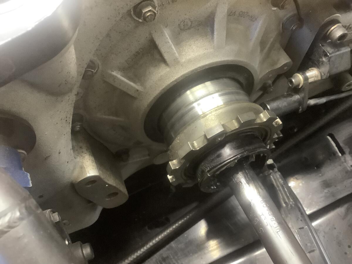

    Im trying to remove the axles to service the tripods. What else do I need to remove so the axle pulls out? Do I need to remove the whole tripod?
    Im assuming I don’t want to whole flange that plugs into the side of the gearbox to come out? It looks like if I remove it, the fresh gear oil will run out. Refer to picture #1.
    This is left side of the car.

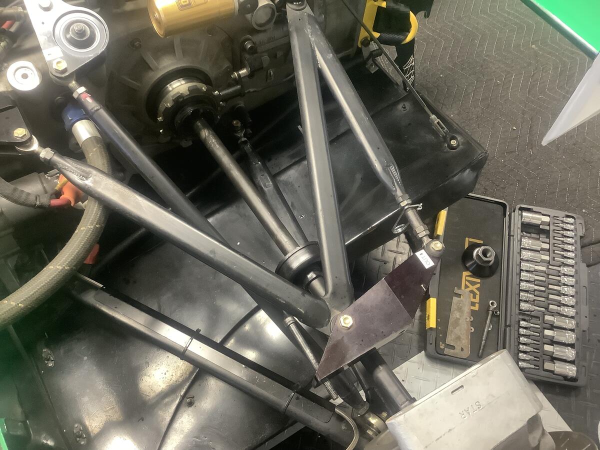

    The part that the rubber boot sits on needs to be removed. I think there is a spiral retaining ring, looks like the end is at about the 3 o'clock position in your picture #2.
    To remove those, you get a small screwdriver under the end tang, and wedge it toward the center, once it clears the groove, it will try to lift out, and you just spiral out the rest of it. Installation is just get the first part in, and squeeze / spiral into place.

    Thanks Dave. Am I correct that I don’t want that notched flange to come out of the side of the gearbox?
    Is there a spiral retaining ring on the wheel/tire end of the axel too?

    Look in the Hewland FTR manual (https://starracecars.com/wp-content/...anual-3-09.pdf), which shows the Tripoid Gaitor setup. After removing the spiral locking ring, the black part will just pull out and you can remove the entire axle / with inner tripod joint. The Tripoid Joint Outer stays with the gearbox.

    Thanks again Dave, I found it on page 51 of that manual. It makes sense now.
