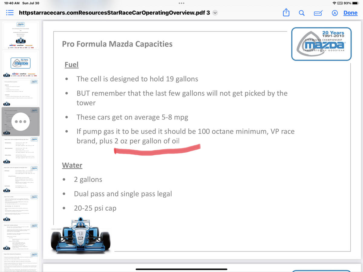

    I’m getting my Renesis rebuilt. I am looking at the 2010 Star Mazda operating manual and it says to use 2 ounces of oil per gallon (pre-mix aka 2 cycle). I’ve been using and been told around 1.3 ounces of 2 cycle oil per gallon.
    The investment to rebuild today is much higher than pre-Covid so I *really* want to make sureI am doing this right. I am attaching a screenshot of the manual for you to see.

    My brother and I ran a peripheral port 13b for 10 years running 11, 000 rpms, in csr and p1 and used 1 Oz. Per gallon with now issues ever, the more you use the leaner you will run. And you won't smoke out the paddock at idle.
