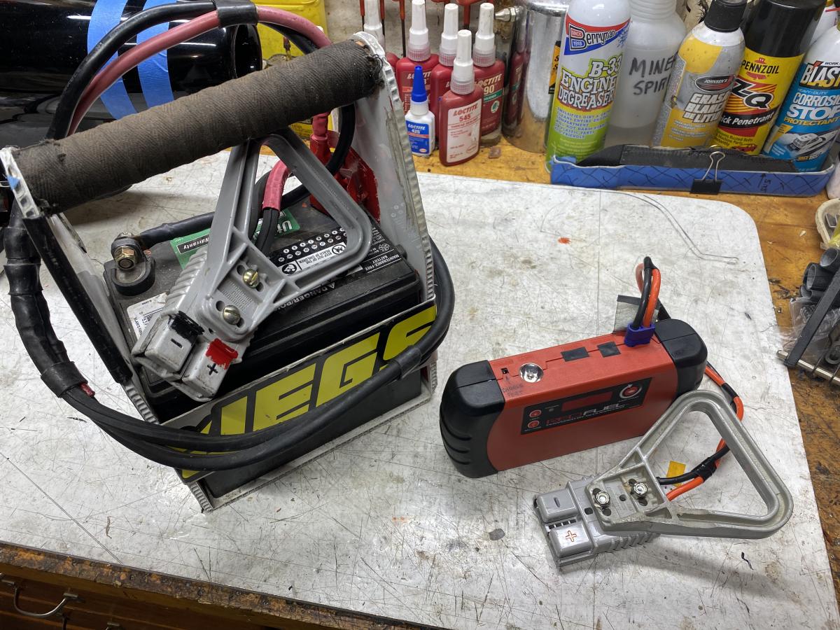

    So what has worked well for my water cooled Super Vee, is a “garden tractor” sized lead acid AGM battery, in a simple carrying box that we use for any jump starts in the paddock (or shop).
    And a second, much smaller lithium (?) type battery, that drops into my crews backpack for starts on the grid.
    both batteries were purchased at our local Farm & Fleet.
    Fletch

    The various minipacks are great as a grid tool for emergency use, but for repeated starts in the paddock they might or might not last out the day before needing a recharge. There's no cheap substitute of a good ol' heavy wet cell, preferably with a handle. Good for multiple cars all weekend long.

    I started using the smaller LiPo jump packs since 2019 - cannot beat how portable they are, and they output good V. Aside of being slightly naïve about any charging risks or dangers, what i DO NOT like is that it self cycles off after about 5s of V, meaning repeated cranking, or cold starts that die quickly require unplugging/plugging to reset the jump. I'm sure there is a way to mod this, but is probably there for good reason.
    This year I switched to small lithium onboard - Braille suggested to never use a Wet or AGM battery to jump inline with an online lithium because your onboard V will immediately try to charge the jump battery creating the exact opposite effect you want. So I'm not totally sure what the winning solution is yet - other than having another $200+ LiPo4 jump battery. Actually, Braille wanted me to just have a bigger onboard and never need a jump.

    There may be others out there, but the EarthX jump pack does not require a reset.

    Do not jump start a lithium Ion battery with a lead acid battery. You will ruin the lithium Ion battery.
