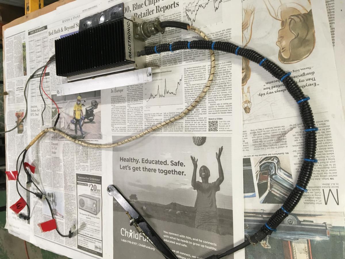

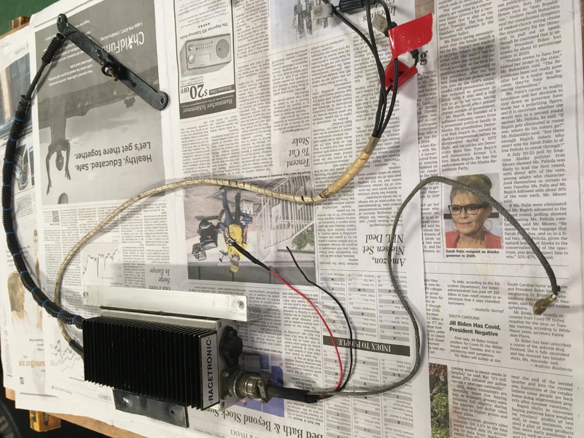

    Hi Everybody,
    Does anyone have a manual or operating documentation for or other carnal knowledge of the Racetronic Electronic Fuel Injection setup as used on SCCA Pro Formula Super Vee RT5's back in the day?
    I'm hustling to finish a down to the tub rebuild on my RT5 to make a race in 2 weeks and I have the Racetronic setup but no documentation. And while it's a pretty simple setup that I can figure out by experiment, I'm hoping that someone has knowledge that they're willing to share.
    In particular, how is the Trigger wire setup? I'm using an MSD Electronic Ignition with crank trigger, but running the spark thru the VW distributors rotor and cap. The otherwise unused points are the logical Injection timing device - when Cyl-1 is firing spark at 36 degrees BTDC, Cyl-3 injector is pulsed at 36 degrees BBDC, etc. Is it as simple as running the trigger wire thru the points to ground?

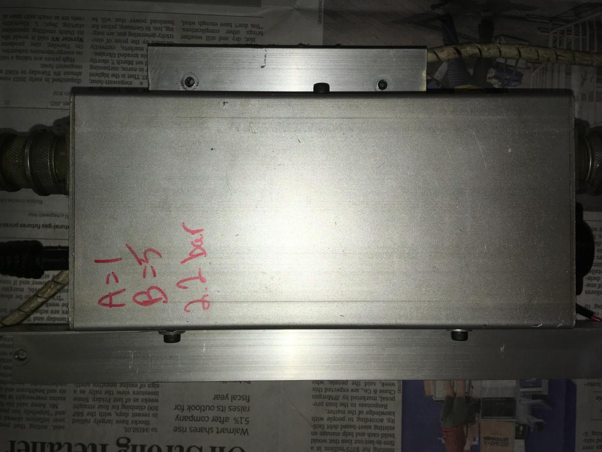

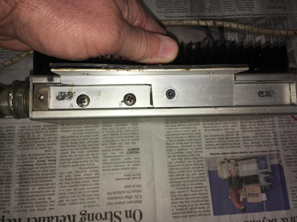

    Also, the Adjuster Screws, A and B, which is Low throttle and which is High throttle? A previous tuner has marked mine on the bottom with "A=1, B=5, at 2.2 bar". I would guess that A is low throttle, and B is high throttle, and that those are Turns OUT.
    Can anyone help me?
    Scott
    RT5-321

    I'm reliably informed by excellent local tuner guy Doug, who has had his hands on several of these over the years, that the Racetronic is surprisingly simple in that every time it gets a signal it fires all 4 injectors simultaneously, and that the timing of the pulse with relation to exact crank position on the intake stroke makes no difference in horsepower, and that you piggyback the trigger wire onto the ignition signal wire. Misc stuff: you need some tension on the cable to ensure that the injectors fire at zero throttle/idle (and so too much and you're rich all the way up). I'll get this all sorted and confirmed and update this thread.

    After a lengthy and painful process, we have determined that the following combination works:
    Running Both the MSD Digital-6 Plus Ignition AND the Racetronic Fuel Injection with a Pertronix ignitor in the Bosch distributor body.
    Run the Ignition switch circuit thru the Pertronix, and out to the Triggers on the MSD AND the Racetronic.
    We could NOT make the Racetronic run alone off the Pertronix, and think that the MSD's white "points" signal wire serves as a ballast resistor allowing the Pertronix to switch properly. All that nice machine work on the crank trigger wheel and pickup mount was for nothing.
    Still don't know details about tuning with the Racetronic cable tension vs the A & B screws, or which screw is which but will eventually screw around with them and figure it out. Would Love to hear from somebody who knows about the Racetronic and has taken one apart.
    The painful part - attempting to run the Racetronic off the MSD's tach output resulted in the rev limiter activating prematurely at 5500 and the tach quickly sweeping to the set (higher) rev limit and waggling there. NOTHING worked to rectify this over the course of a 5 session race weekend.
    Scott
