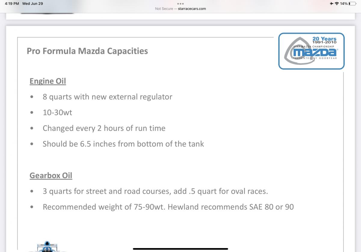

    the Star Race Cars manual for the PFM says the oil must be changed every 2 hours. Seems like a lot. I’d have to change my oil in the middle of a race weekend or even after just 1 long training day. Is that how frequent folks on here are changing their oil?

    I’ve done 4 track days with my existing engine oil and gearbox oil. Each track day I do 2-3, 30 minute sessions and I’m thrashed. Changing the oil every two hours sounds very excessive to me.
    My engine oil is not black yet, and the gearbox oil is still clearish. I’ll change both oils this summer.

    Change the oil and clean the filter after every weekend
