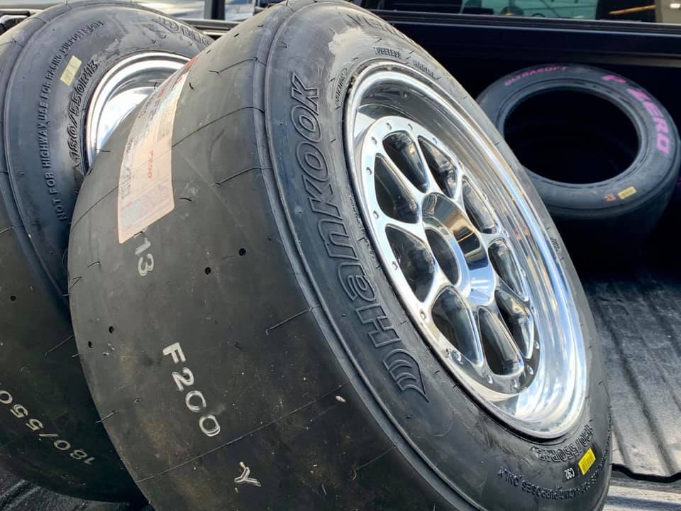

    This is a front Hankook mounted up - nice and square.
    -Mark
