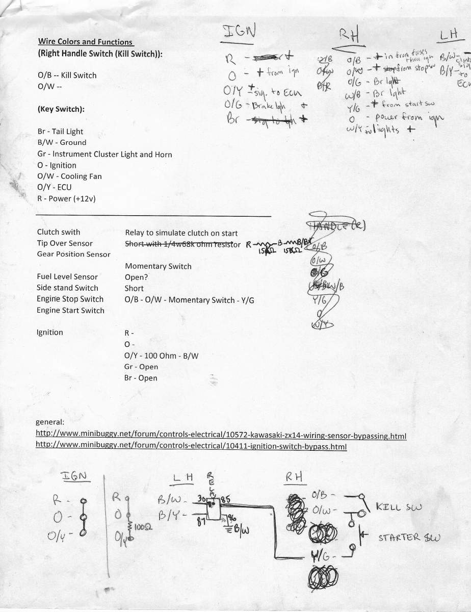

    Here was my cheat sheet for the engine harness stuff. bottom is how to wire up the stuff for the starting and running. center section describes the different sensors. I didn't have the EXCVA on there for some reason but i think i just disconnected it and pulled one of the wires from the ecu plug.
    basic things are:
    clutch switch needs relay during start or you will be stuck in safe mode
    side stand switch short
    tip over needs a resistor as described below
    ignition switch needs a resistor to simulate the key being in circuit
    http://www.minibuggy.net/forum/contr...tml#post158256

    Very helpful.
    Thank You
    Will
