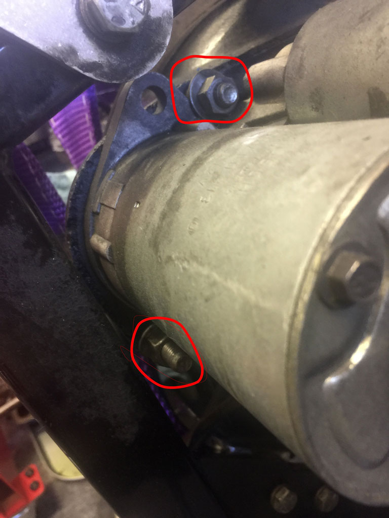

    Thanks everybody for their help so far, I've finally managed to get the motor out. So far, so good, but while taking it out I noticed that the starter motor is clamped to the engine using the two bolts circled in red and some washers. Is that the normal way of mounting the starter on one of these cars or is it an indication that I've got the wrong starter on mine?
    Normally I'd expect the starter to be mounted by the ears, but the solenoid doesn't allow the starter motor to be turned further to the right.

    That is the correct way to mount the starter. Due to the routing of the exhaust it is the only way to mount it.
    Dave

    There is nothing wrong with the standard starter set up used on the "factory production" Evolution FST.
    However, I bought a "kit" from Campbell Motorsport and modified it in a number of ways. For example, I had "Roxannes" make a new header pipe and used a light weight aftermarket starter that bolts in without rotating it.
    My car uses a "Rhino Case transmission (as allowed by the rules) and does not use a front mount for the engine. I added rear bracing to stiffen the frame and to avoid using the engine as a "stressed member" . I have recently moved from Southern California to Grants Pass Oregon and will be driving with San Francisco SCCA region as well as the SCCA Oregon region in FST. If you would like to contact me let me know.
