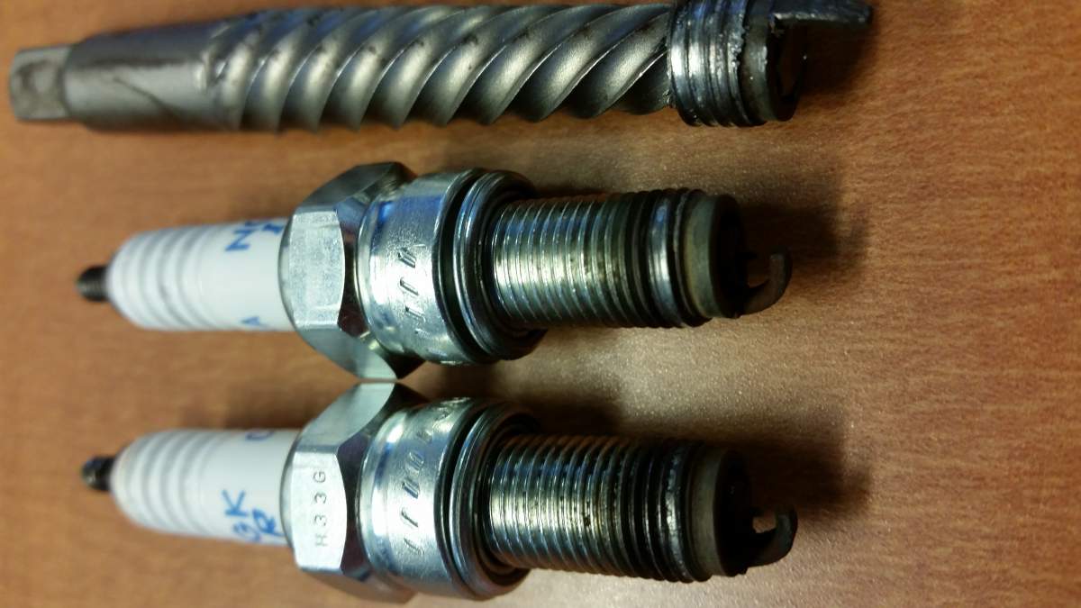

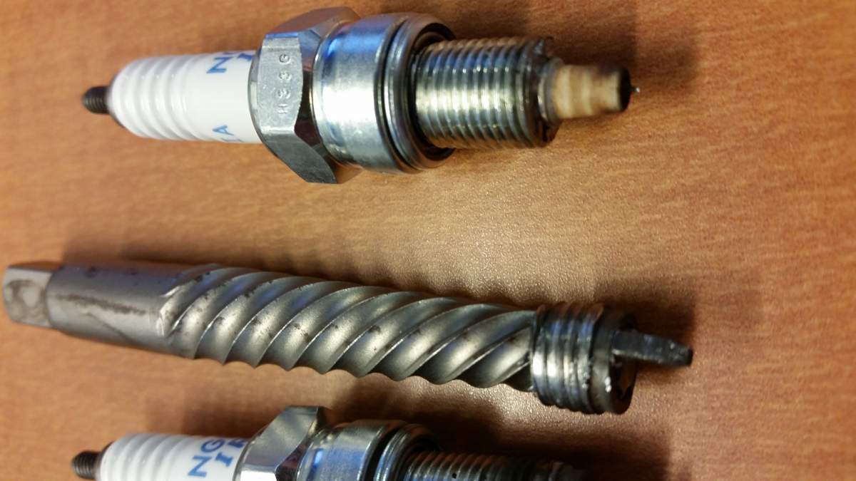

    Well after a lot of effort, I got the ugly puppy out. I broke several sockets and adapters in the process, but it went up two sizes on the easy out before it finally started to move. I really dIdn't think the last one would fit in the hole. I got the other 3 out as well but sprayed wd40 around plug beforehand which helped. Of those 2, the last few threads of plug were galled. I ran the good plug thru the other 3 holes and ok on 2 (including one that broke) but 3rd could only get plug halfway down. Will try with new plug. If that does not work, may consider grease coated tap to clean up threads and hope grease retains chips but will clean as best I can. Trying to avoid pulling head. We'll see. Thanks for the input.

    Default Pictures of the Operation check
    Thanks - here's some pictures of the ordeal!

    Run either a tap down the hole to clean up the threads, or dremel some grooves in the sides of a good plug to act as a chaser. in either case, you will need to get the filings out of the cylinder afterwards.
